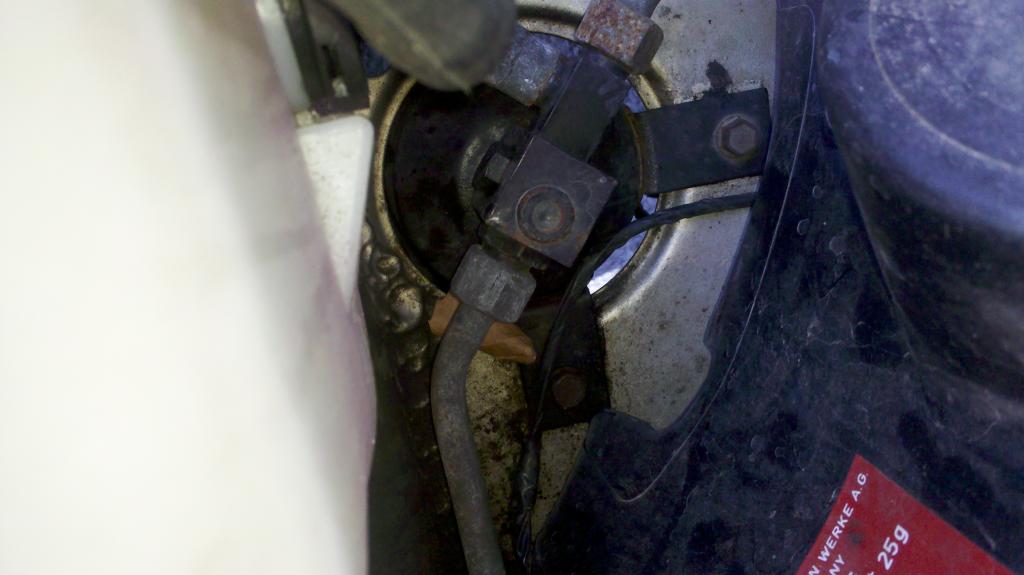

    Im looking for the high side line that has the test port in it, which runs along the p/s fender and goes behind the hood hinge

      which one, there are two versions, get the right one or it wont match up with the drier.

        What do I need to know about the two verions?
        Mine is a 1990. The fitting looks like this- a 21mm hex fitting on both sides of the line.
        BTW, how do you guys keep the 134 adapter from being sheared off by the hood hinge? thats what happened to mine
        Pay no mind to the red r12 sticker, I got that black trim from an older car
