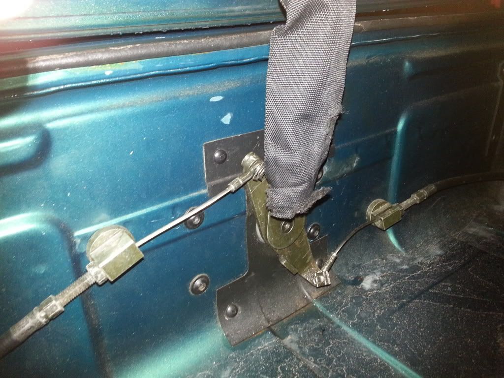

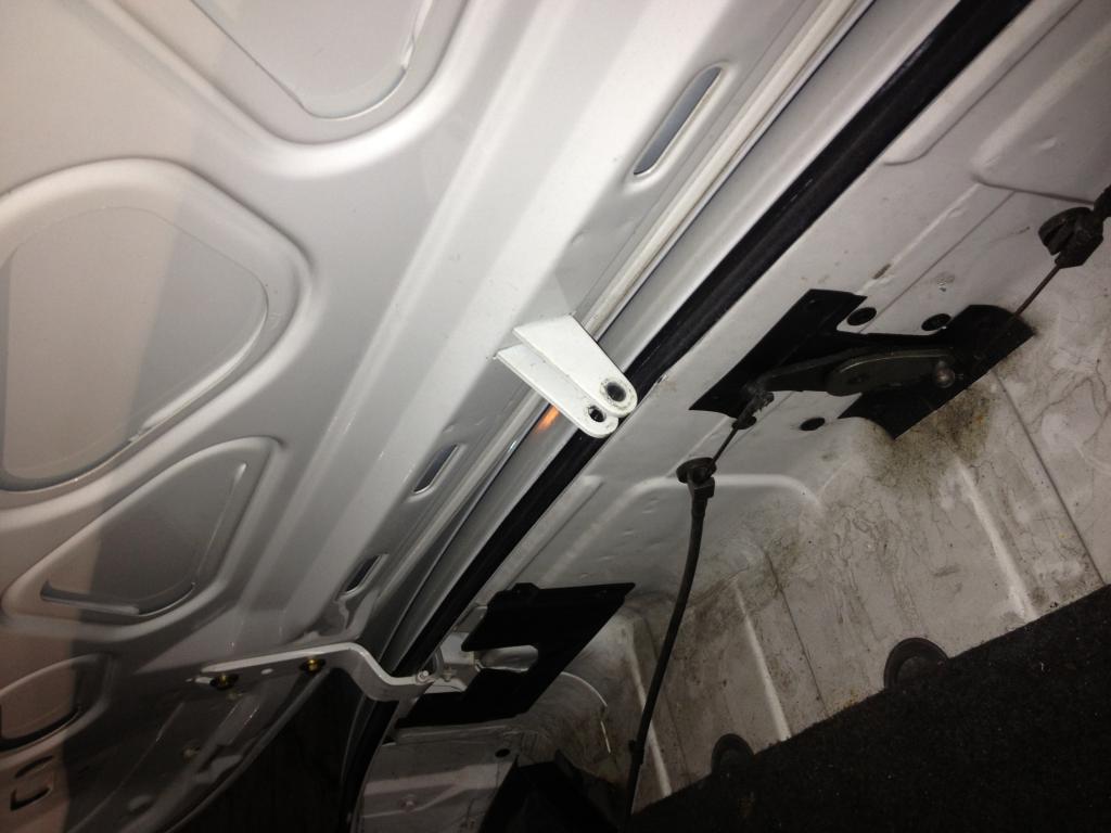

    So I have a 92 with an auto vert and I think it's missing some kind of arm that's supposed to raise the door for the soft top compartment. I need either that arm or the parts to swap it to a manual top, thing is I don't know what I need exactly so I need some help :|

    Have a picture of where you think something is missing?

      Probably item # 2 http://bmwfans.info/parts/catalog/E3...n_folding_top/

          Yeah this is what mine looks like

            Boomer is correct then. Buy the arm, and associated pin, bushing, and clip and your back in the exclusive working power top club!
