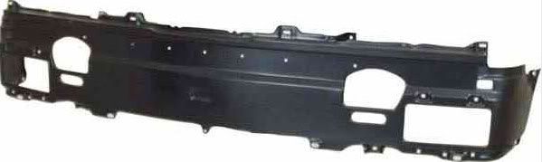

    Hello.
    Well I need a early euro e30 front valance so I can finally finish my m tech 1.
    Also looking for early euro fog lights. And front m tech 1 bumper trim.
    84 325e Burgundrot S52 M Tech 1.

    I think you need the later fogs for mtech, no? The ones for the 86-87 valence.

      I'm not sure exactly now that ya mention it. Which ever ones will work in the mtech 1 valance I guess.

        to clarify, the "later but still early" fogs are the ones you need. There was a valence change on euro cars between 85 and 86, you need the fogs from after this change.

          Ok, so would that be the valance that I need as well? The 85 86 one? I was hoping the mtech 1 valance just fit on to the euro bumpers around my US valance after cutting one of the tow hooks but I guess I need a euro one. I suck at researching haha.

              Man I have a headache. It seems that thread is about a guy with a replica tech 1. I have the euro bumpers on my car. I guess that the diving board valance under it is the problem because the fog light holes aren't big enough for the "early but late" fog lights? But looking at my us diving board valance, it looks a lot like the early euro valance anyway. Small difference I guess.

                US: http://i57.photobucket.com/albums/g2...um_noplate.jpg
                Euro:
                See the location of the fogs?
                • Aviator
                  • 616
                  Ok yeah the euro fog holes are farther down? I guess it's the part # 41331933772?

                    41331933772, yep. That's the one.
