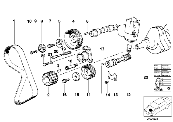

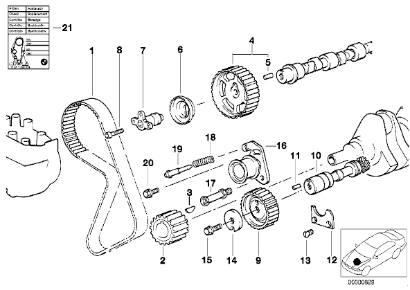

                    I also believe this is incorrect, as both cams should have the dowel. The only difference is that the earlier units had the adapter that allowed for adjusting/turning the cam with a 1/2" socket mounted to the outside of the camshaft timing belt gear. The later units had the three bolt adapter on the outside of the gear for bolting the rotor to the cam.
                    I attached the two real oem pictures for example. Both pictures are taken from an early('84) 320i euro. They show the differences between the distributor model and the camshaft mounted distributor(motronic) model.
                    Basically, the dowel is necessary to ensure that the gear doesn't spin. In all cases, the dowel holds the gear in the correct position for lining up the timing.
