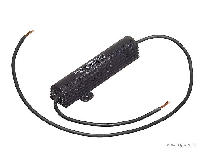

                how easy is it to reuse the fan blades? i failed at separating the fan from the housing because of the temperature sensor. could not figure out how to remove it from the housing. any insight?

                  Fan is held in by 3 nuts at the back. They are usually covered in a sealant, so chip away at the sealant and undo the the nuts. Next, on the front of the fan you will need to push down the end of star shaped locking plate so that you can undo the nut. Undo the nut and push the fan off the shaft.
                  When reinstalling the fan blade put locktite on the back nuts. Push up the side of the star shaped locking plate on the front of the fan once you torque down the front nut.
                  As for the wires, they should just come undone at the resistor using 2 screws. Don't cut any leads - there should not be a need to.

                    yeah i had the first part checked out. the nuts were all rusted to shit and just sheared off. but the motor still separated. the only thing holding it back was the wiring to the resistor which is installed and the fan housing. however, i dont understand the fasteners used to hold it. they look like one time use pop rivets or something. not screws.

                      Pop rivets on the resistor?? Magna or Bosch resistor? Sounds like a Magna maybe.

                        not sure, how can i tell?
                        im pretty sure i dont have the magna fan, my car is a 1990 and it has 6 blade fan. ill snap a picture of the resistor tomorrow.

                          my resistor looks nothing like this bosch
                          on the website, the guy mentions that there is a plastic encased magna, that's what i have.

                            Yea should look like this then. If that is the case, you have to splice it in, but my fan is a bosch, so I'm guess this might not work. Never tried swapping them.

                              it looks like this
