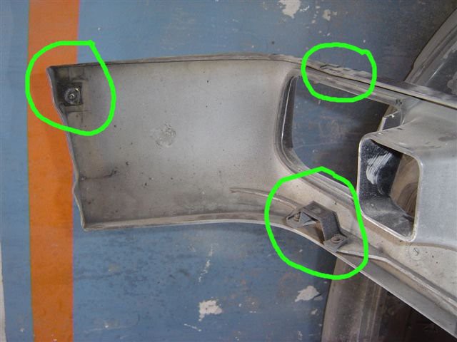

    I'm wrapping up my Mtech 2 conversion and i'm missing a few random pieces, as follows:
    1. In picture attached there is a bracket that connects the bottom of valence to car, need two of those
    2. I have the MTech 2 brake vents but i'm clearly missing a piece that joins the ducts to the valence openings, need two of those (would hate to use duct tape)

    the bracket, on the bottom of the front spoiler, are riveted on, and are not sold separately from the front spoiler.
    the clips that secure the top of the spoiler to the valance, are still available new from the dealer.
    the "clamping bolt" (as BMW refers to them) - that secures the sides of the spoiler to the valance - are NLA (last i checked) - you might go to the hardware store and find something similar that would work.
    https://www.realoem.com/bmw/enUS/sho...diagId=51_0659 - here is the break down of how the front spoiler gets mounted to the valance.
    best of luck
