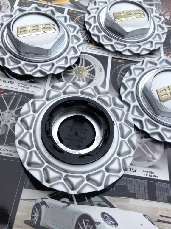

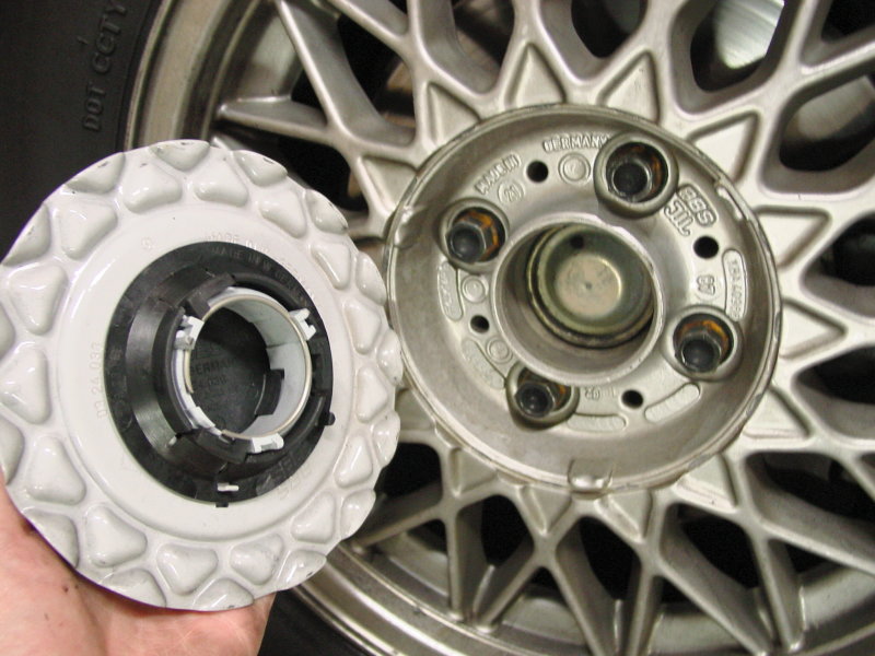

            Hi dsphil, as explained by rzerob, this adapter allows you to replace your existing hubcaps with these (imho) better hubcaps with an improved locking mechanism shown below:
            These clamp on to the outer rim of the hub. While the hubcaps clamp onto the inner rim of the hub.
            The adapters are press fit, so it won't come loose until your press/knock it out from the other side.
            Hope these answers your queries.

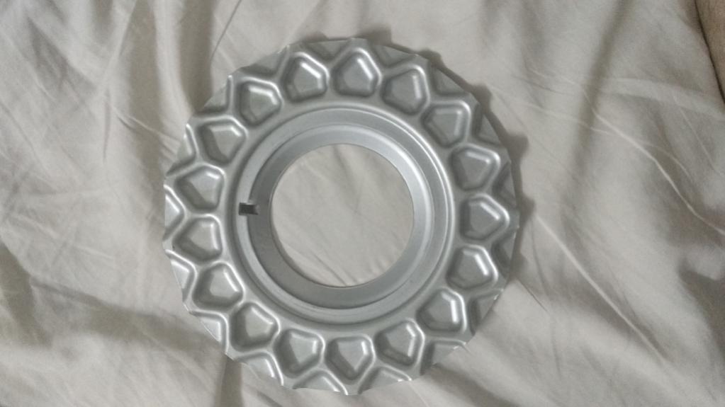

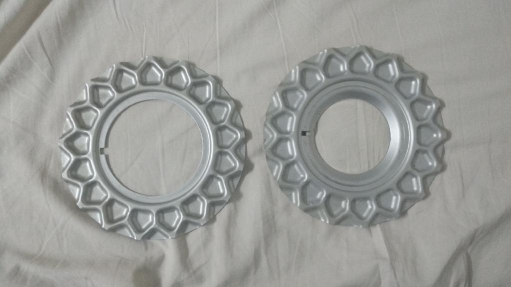

                    As promised here are the side-by-side comparison of the two waffles. I shall say it right off the bat that you'll have great success modifying your current waffle to fit the new locking mechanism, but IMHO it's not worth sacrificing a waffle which can be had new for only $5 apiece currently. But that's just my 2 cents.
                    Here they are sitting on top of each other. So all you need to do is remove the inner rim and slightly enlarge the notch and you're all set. But I still feel it's a waste of a good waffle.

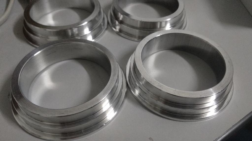

                      Just an update that these are ready to ship out! Will deliver them tomorrow and update you with a tracking number.
