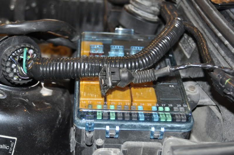

    Greg, that adapter you sold me: what year/model of e30s is it good for?
    should be any 88+ 325i or 318i just make sure you give them the jumper harness for the abs/oil level sender

        Dude just wanna say props to you for making the electric side of swapping this much easier :up: ...I could be gettin one later this year, we'll see

          make for 1985 325e?

            sure do

              I'm doing a m50 swap to my 86 325es. Will your product work on hooking up all the connections necessary to complete my swap?
              i was gonna have the wiring done myself, but if this is easier ill go with it.
                correct the adapter will plug in between the factory wiring on you e30 body side and the m/s50 motor harness.

                    Does your adapter fix the O2 backfeed problem some cars have?
                      http://www.r3vlimited.com/board/showthread.php?t=192533
                      I had a chance to look over dave's car about the cel for the o2 code and it tuns out the o2 sensor was to far from the head and was trowing the code. adding a o2 bug within 20in of the head fixed the problem
                      as for the mod to the harness, this is simply adding an interdependently switched 12v+ on signal(via the keyed on) to the o2 sensor circuit. where as the adapter allows the dme to switch the circuit on

                            What does this part of Greg's harness plug into? I basically have my swap all hooked up and I have nothing left for this?

                                oil sensor on the oil pan.
