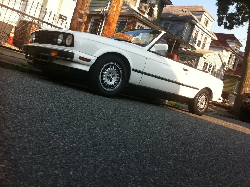

                        Pm'd -
                        I know this isn't the place, Registered just to get a set of these coils!
                        Before: As you can tell I really need em lol
