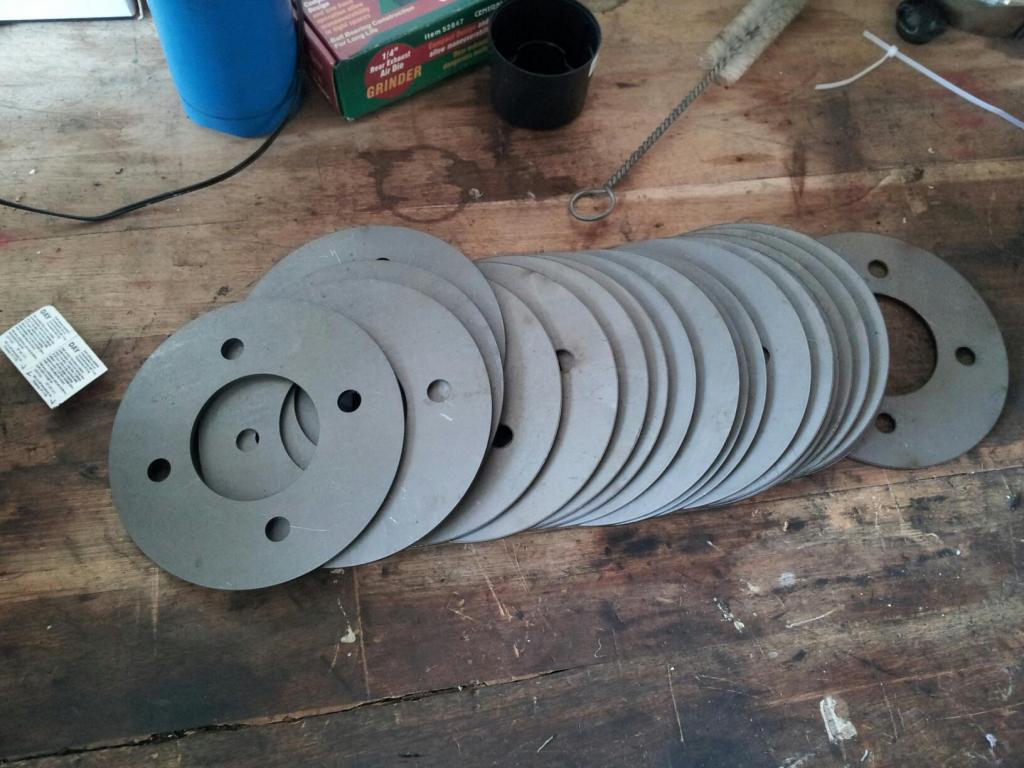

      Originally posted by akorcovelos
      Are you making/selling the 1mm spacers needed to make up for the lower hat thickness of the Corrado rotors?
      Yep, As a matter of fact i cut them out yesterday. I have enough spacers for 10 kits "thinking ahead"...
      This kit comes with everything you need. Total plug and play bbk...
      • MonkeyMadness
        • 3251
        #63
Name:	bbk spacers.jpg
        BBK Hub spacers in the house!

          Nice. So when should we expect the rear kit. I have some good ideas.

                                Originally posted by MonkeyMadness
                                I'm thinking about
                                1 1/2 weeks for shipping
                                Then i have to modify and build the Kits
                                turn out the disc's I.D. of center hole
                                Remove the "MAZDA" from caliper and cut down lower mounting ear.
                                Laser cut the hub-centric spacers
                                Rebuild, blast, paint the calipers
                                So I'm guessing around 3 maybe 4 weeks depending on any issues that come up...
