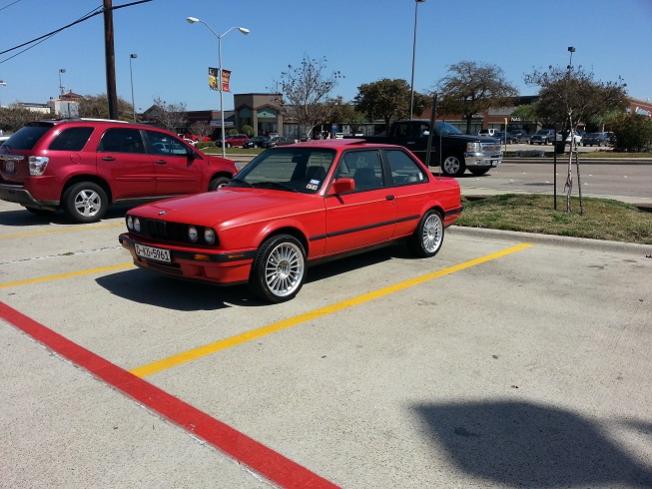

                  Found out the noise was coming from underneath my e-brake not at the hubs like the cable was too loose. The right side was indeed really loose. Turned the adjusting nut few times and noise is gone.
                  Here is the whip cleaned. I need to get coilovers ASAP. I put on 215/40/17 Kumho AST tires. It is actually flush with the fender.
                        is that stock ride height? trying to gauge what mine will look like with H&R Races

                          yes stock iS.
