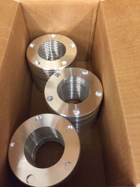

There are kits available! If you send your money and make sure your shipping information is filled in correctly to nasieg you will get added to the list!
Here are some progress pics:
