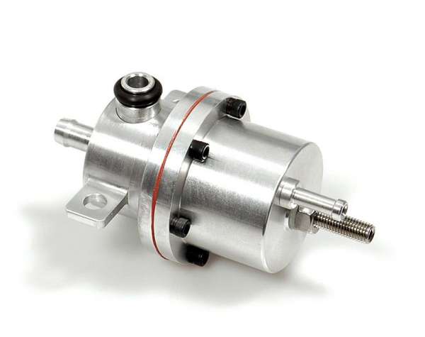

    Group buy for stock fuel rail mount billet adjustable fuel regulator's.
    Features include:
    100% American made.
    100% all billet aluminum construction.
    100% rebuild-able.
    Viton 3-layer diaphragm rated at 100 psi constant and 300 psi burst.
    Totally adjustable from 30 psi to 100 psi.
    Separate vacuum port, no removing the line to adjust.
    Direct replacement for stock regulator.

      To answer your questions..
      1.What are the benefits of this product?
      Well, this gives you the ability to manually tune the fuel pressure to adjust for changes in the system. Such as larger injectors, larger fuel pumps, higher fuel demand, ect.. It's a tuning aid. Also, this one works with the stock fuel rail. Most do not, most require the use of an adapter and a remote regulator. This costs more, and adds complexity (custom mounting brackets you have to make, extra lines to and from the remote regulator). This one is also rebuild-able, most are not. A stock replacement regulator will run you 75-100 bucks, so there that too.
      2.Would you recommend it for an ITB and Turbo setup?
      Yes I would, I would recommend one for anyone doing any sort of mods to an engine. I've never known a performance car that doesn't use a adjustable fuel regulator. It's considered a standard and one of the first fuel system mods that should be done. And I can attest personally to the quality of the product. I've installed these regulators in probly 100 cars myself, ranging from simple bolt-on cars to fully built race cars. Power levels ranging from 300 to 1200+ hp cars.

                  Sorry to take so long updating this. To answer some of the question's that have been posted.
                  1. AN- fittings. There are no plan's to make it accept AN fittings as there's a unit that has that already if truly interested in that style. The upper vacuum port is a threaded design on these and I believe the fuel return port on the bottom is aswell.
                  2. Rebuild kits. These regulator's are produced by a friend's company. Kirban performance. Their mostly known within the buick gnx and mustang worlds. But produce this regulator for a porsche fitment, which is the same as ours. Rebuild kits are available direct threw Kirban.
                  The group buy must be full on this before the order is placed. Because this is a low volume piece the pricing deal is for a batch of ten total. They normally run between $160-190ea. range retail.
                  Thanks, Matt
