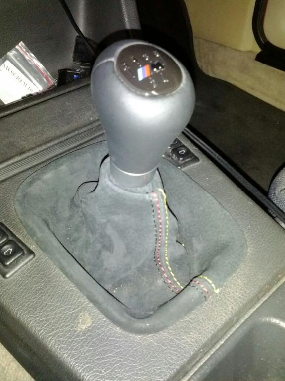

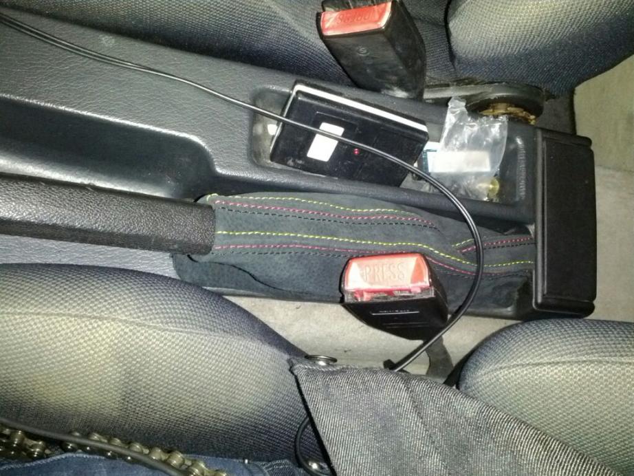

        Only pics I have will try to get some better ones

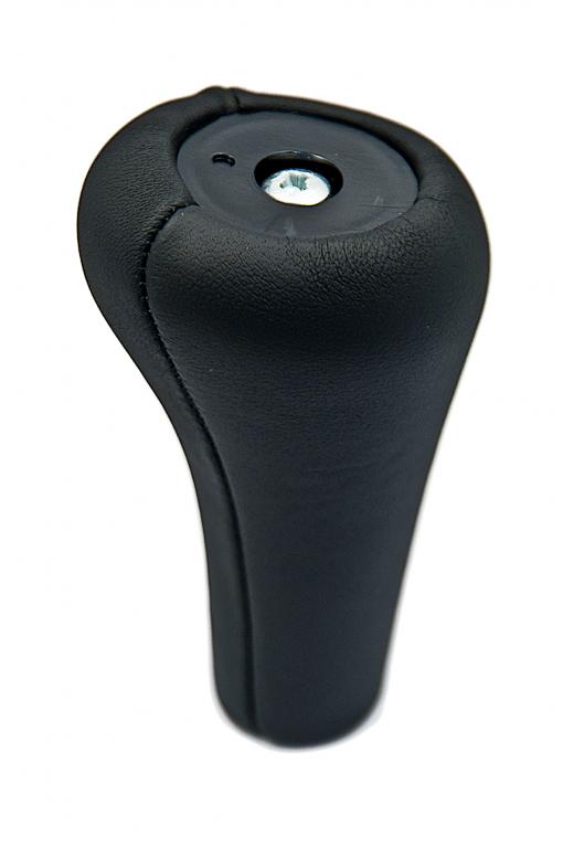

                The shift knob cover is a funnel peice that fits the standard shift knob up until the top I got it on but without some sort of glue it looks like a funnel. Ill be back with a picture when i figure out what glues leather to plastic.
                not bummed or happy about it yet but extremely happy with the boot.
                edit unable to remove the plastic plug on top of the shift knob( the diagram with the gears) it seems permanent. if i took it out, it would be ruined and id need a source for another one. overall I threw it in my glove compartment for some day when i feel like a hassle. the project will be to put elastic in the shift knob, somewhat like the shift boot.

                  If you haven't figured it out yet, you just need to stick a small flat screwdriver underneath the emblem where one of the leather seems is to get the emblem off. It's double sided tape holding it on so don't try and pry from the very edge or it WILL chip the emblem. Shove the blade further and further in and then you can lift the handle up and it should start to come up. Then there is a screw holding the plastic plug down. It's what holds the top of the leather tight.
                  Don't try elastic or anything, it is easy doing it the proper way. Just get some of the Barge cement or "Tanners Bond" from Tandy Leather Factory on amazon. That's the sort of stuff they use when sticking the leather on from the factory. (It has a little less bonding ability than the "pro" class stuff, but it also has less fumes that will mess you up or give you cancer.) The stuff dries pretty quickly but is very rubbery and strong, so it will hold the leather tight for years compared to the "wrong" stuff.

                    hey man thanks. comes out so easily I wonder why I wrote that.
                    It looks like some big plug thing but its like 5mm thick
                    back to that.
                    doesnt even need to be glued but it should. If you can pound it back in with the leather it holds. I bet it pops out too though.
                    its a peice of plastic in a rubber hole.

                      If you have the standard leather knob, it should look like this once you scrape away the doublesided tape that is left over from peeling off the emblem. Just unscrew that screw, put a thin coat of contact cement on the rubber part, slide the leather up from the bottom, fold it over the top, stretch out the wrinkles and hold it the glue starts working a bit, and then just screw the top plastic piece back in to lock it in place.
                      There are 3 pieces to that lever: The rubber outer piece, the plastic inner stem, and the top piece with the screw that screws into the plastic stem to hold the leather down and to also hold the rubber piece up on the stem. (When they're old knobs, the rubber part can easily slide off the plastic part once the leather is removed. That's why I also use some cement on the plastic core before putting it back into the rubber core as well)
                      Sometimes it's tricky to get the seams into the channels and looking nice if the leather sleeve wasn't sewn just right, so good luck!
