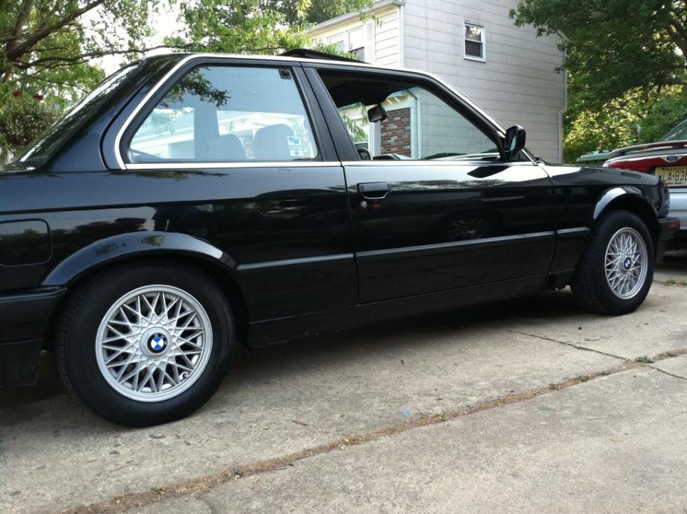

                              My ride Height is wacked out I'm about half way on my collars in the rear and all the way down on my front... Click image for larger version
                              • Vivek
                                attention whore/retard/bitch
                                • Oct 2011
                                • 6167
                                #45
                                Pics of the front setup? I'm pretty sure you did something wrong...with my fronts all the way down I can lean my phone sideways on the lip (although my tires are small).
