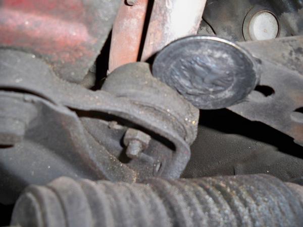

    While I was using my 666 Manifold adapter, I lost my heat shield for the stock motor mounts and since then, my motor mounts would not last me more than a single event.
    Polyurethane lasted me even less time.
    So I decided that the only way to solve this would be to go with solid motor mounts.
    My current bushing setup:
    Solid Motor Mounts
    IE Polyurethane Tranny Mounts
    The installation was fairly straight forward. It's a bit challenging with the bolt being completely separated from the mount, so lining up the engine arm with the subframe can be tricky.
    I had my car on a lift and used a transmission jack, which allowed me to do it with ease. Installation took me no longer than 10 minutes for both sides.
    Many mentioned that there would be a lot of vibrations and that it would be pretty unbearable... rattling my teeth off. After driving it around for a few days and a track day later, I can tell that there is very very little vibrations from the motor. The drivetrain is smooth as silk. :)

              i was just in a fender bender at about 15 miles an hour and my motor mount on the passenger side sheared the entire bolt off as well as my tranny mount and my motor/tranny cammed forward about 2 inches im up in the air about what mounts to buy because i plan on autox when im done fixing it up any suggestions i was just looking at ie poly urethane mounts or the akg but thing is its a DD any help appreciated
              tia josh I
                I have no vibrations whatsoever with my solid motor mounts. The tranny mounts are what seriously affect your driveline vibrations.

                  I don't exactly DD my car but I get a LOT of seat time in it and I have both poly engine and tranny mounts from AKG. It vibrates a little, but it's certainly not unbearable.
                  Plus I don't forsee them doing this bullshit anytime soon, if I hadn't already removed my engine driven fan, I'd be radiator shopping as well.
                    tell me about it
                    i hear you there except that my fan is scraping my radiator too it was soooo damn close im still in shock
                      You should weld in the turner motorsport reinforcement plates while you have the mounts out....
                        these??? can i just buy the cups?
                          Erik,
                          did you remove that 1/2 cup thinge that the stock mount has?
                          it kinda hooks to the front of the subframe then cups the stock motor mount on the back 1/2.
                          I don't think i need to keep it with my solid mounts, but wasn't sure. seams like i can't bolt the lock nut down all the way with those cup thingies in.
