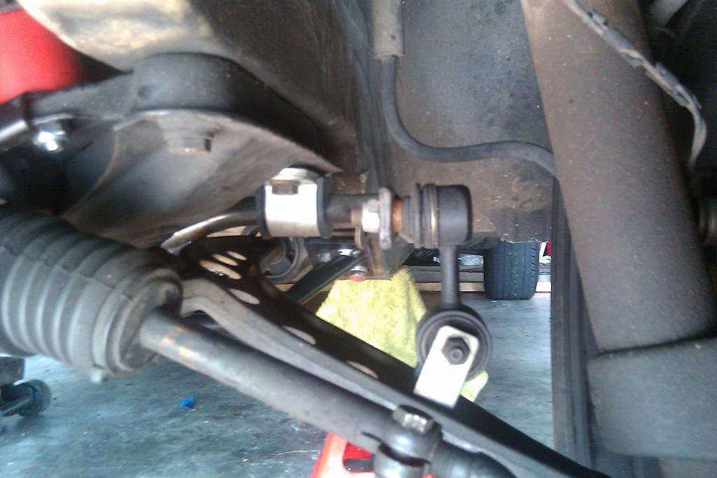

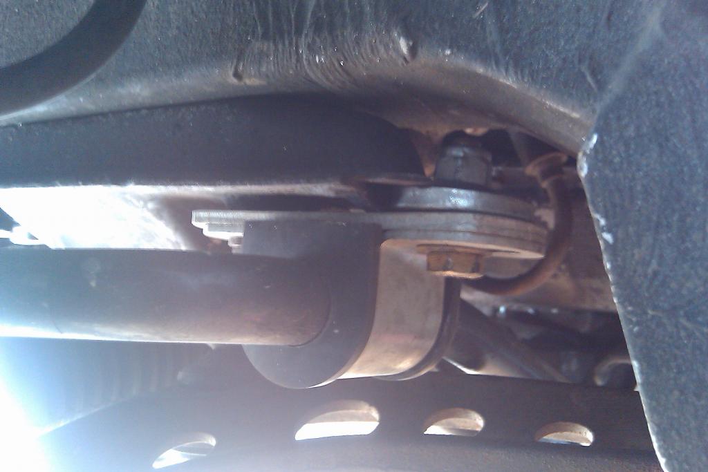

                  #128

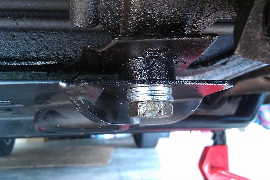

                  How do i stop rubbing!?!?!?
                  soo im back! haha
                  and still having rubbing issues. this time I have pics tho. I tried putting washers in the bolts where it goes through the steering rack. Lowered the car and it immediately rubbed. I also dont like it this way cause the bolts just barely reach the nut..im not sure if theres enough bolt going through the nut up top so im going to try washers at the lolipops, where the cross brace connects there.

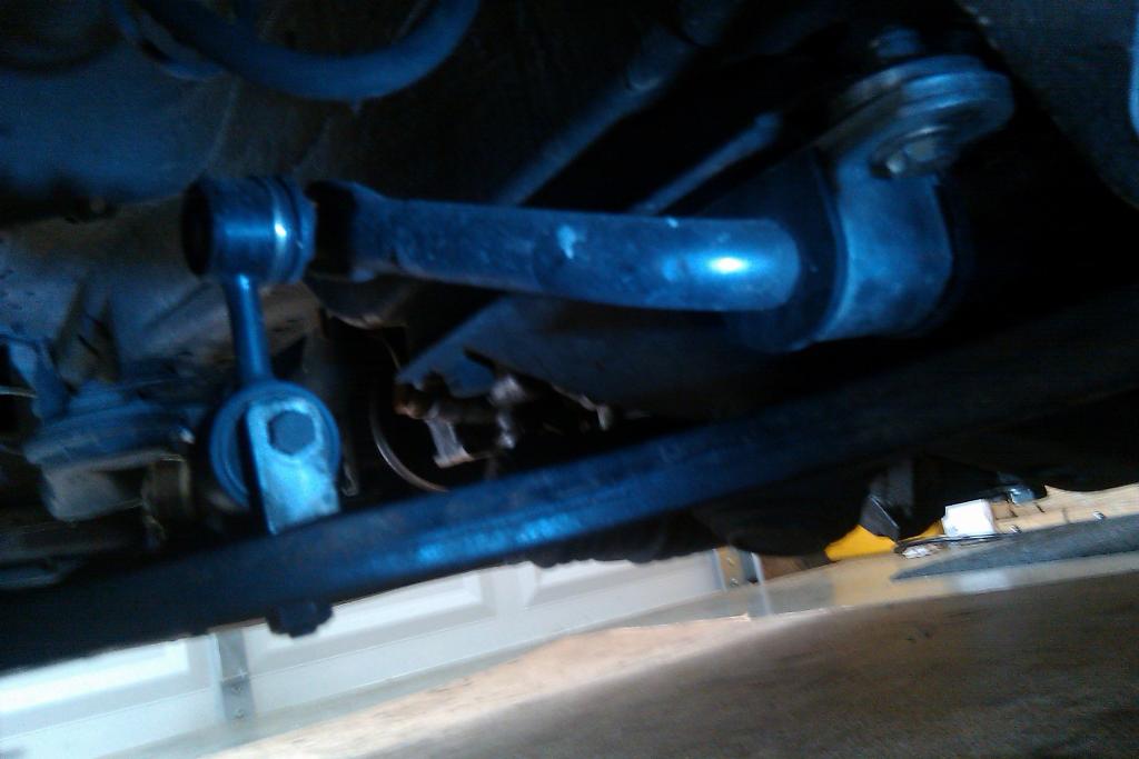

                  Is this pic below not how it should be installed at the steering rack???
                  And this pic below is with the 3 washers. But the bolt only goes about HALF way through the nut up top..that bad?
                  I have a suspension techniques 22mm front sway and only HR sport springs. its not like im 2 low. I just dont want things rubbing making noise. Some ppl say it wont do anything and i should just not worry but i dont think the sway is seated where it should be since it rubs so hard first. and now rust!
                  m20 is plenty. im simply a drifter.
                  build thread -- http://www.r3vlimited.com/board/showthread.php?t=206510
                  • Wishno87
                    • 6025
                    #129
                    Umm shouldn't the washers be on the other side of the cross brace if you want to lower it?
                    • ejnight
                      • Apr 2007
                      • 3488
                      #130
                      Yes

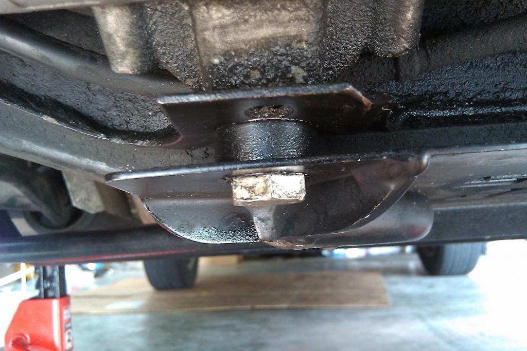

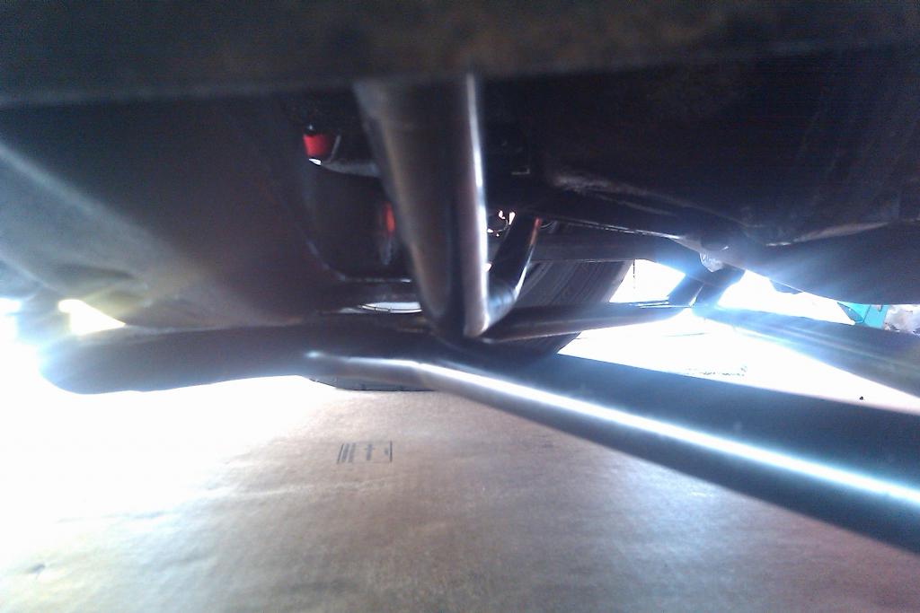

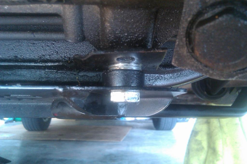

                            #133
                            haha..my bad..i changed em over immediately and took pics today

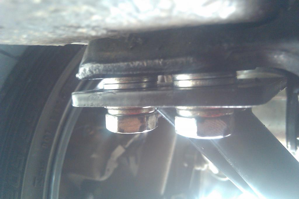

                            washers @ the lollipops
Name:	cross-brace lollipop washer.jpg
                            and washers @ the rack
Name:	cross-brace steering rack washer.jpg

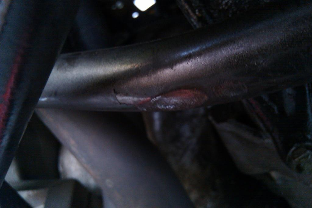

                            and still touching...Click image for larger version
Name:	Cross-brsce touching sway bar.jpg
                            im running out of ideas. and i retightened the sway, which was already tight
                            • ejnight
                              • Apr 2007
                              • 3488
                              #134
                              Its hard to tell but from looking at my cars with stock bars and 25mm aftermarket your bar looks to be forward of where mine are.
                              http://raceskids.com/
                              • ROLLingKING
                                • Apr 2011
                                • 1169
                                #135

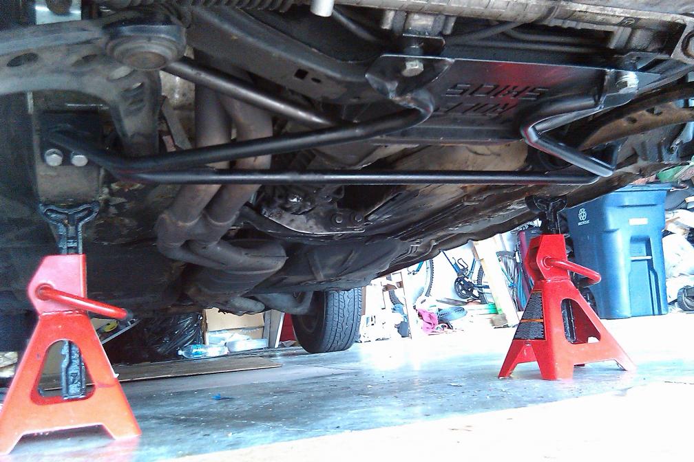

                                You were right this whole time ejnight...it turns out someone said that their 22mm IE sways did the same. I think its just the way the bends are in my sway bar..I checked everything and snapped some pics when it hit me..
                                While my car was jacked in the air my sway bar was horizontal...someone told me it should sit horizontal while the car is on the ground. So i lowered the car with my jack and my sway bar points UP for some reason.
                                I believe its the design of the sway bar so ill have to get a different front sway to keep the cross-brace, which i def wanna keep. like i said, i like it a lot.
                                Heres pics of the bar set up and tell me if it looks normal and if you reach the same conclusion of it being the bar design.
