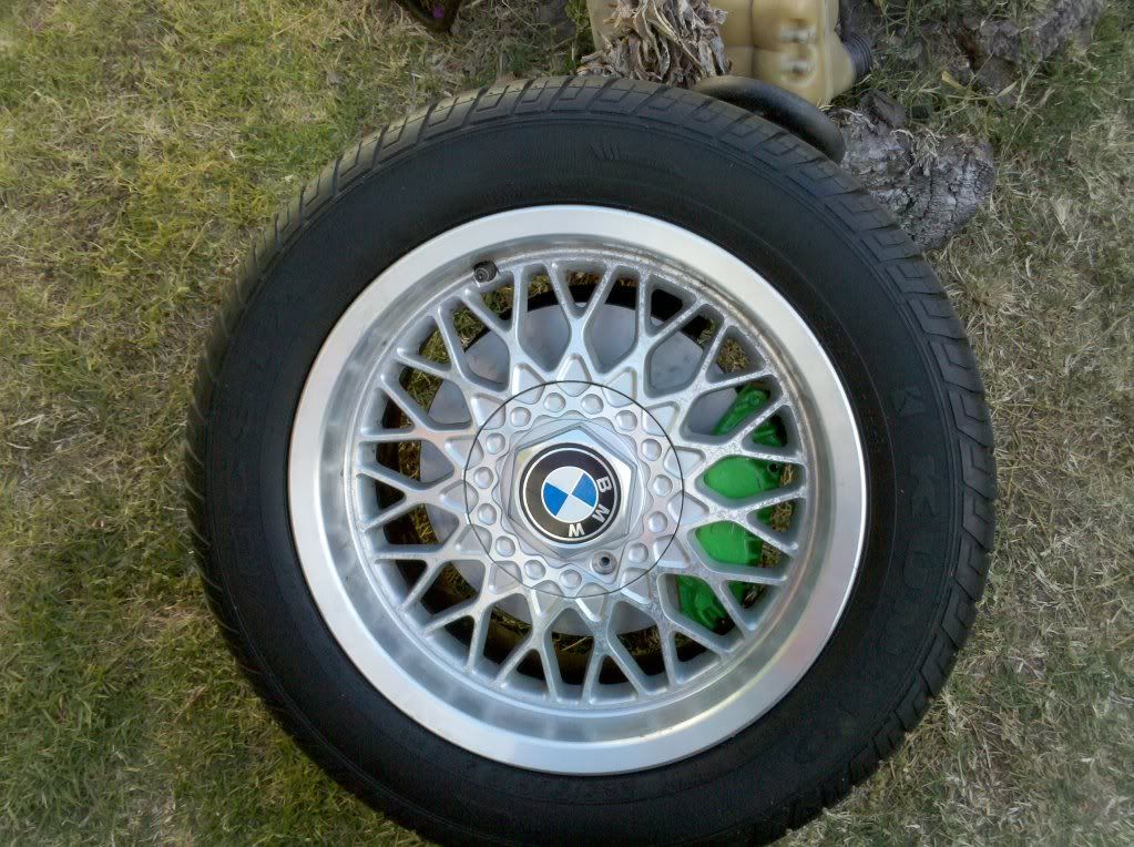

              Are these still being sold for the gb price? I might need a set of those brackets and hardware. Do these brakes fit behind the Remembers and C1s?
              • einstein57
                • Jun 2007
                • 10780
                #172
                They fit Ronal LS' with 15mm spacers

                    Originally posted by einstein57
                    They fit Ronal LS' with 10mm spacers.
                    Nice, Just what I needed. How much leeway is there between the caliper and spokes? Enough to cover bearing slop?
                      Ed
                      There is about 2mm with the nub ground down half way.
