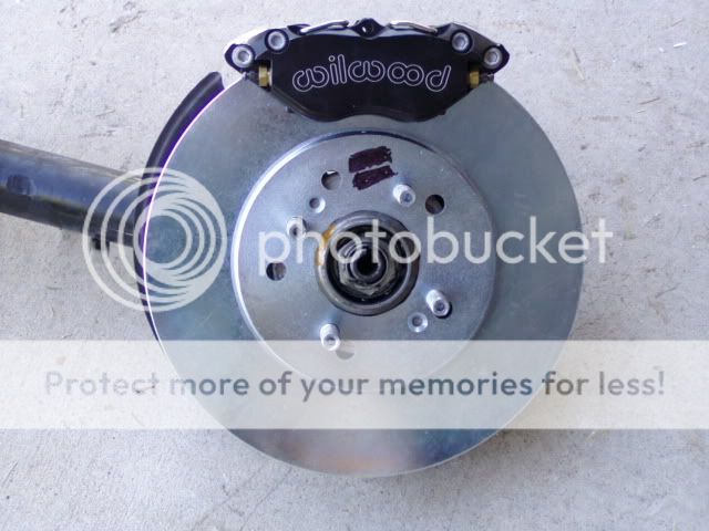

We have figured out how to use a production rotor that has almost the exact offset as the stock E30 rotors, plus it has the same face thickness so no spacer is needed for the hub centric.
This rotor WILL stand up to race conditions as it is from a $50K sports car and these cars are tracked all the time. Plus they are only $60 each to replace. The rotors WILL have 1 hole that overlaps the current bolt pattern.
Before anyone starts questioning this, please keep in mind we have been selling rotors like this for the past 10 years with ZERO issues. The stresses placed on the rotor ARE NOT directed at the overlap hole area. We could make a 2 piece design but it would raise the kit price by at least $300.
We'll mock up the kit next week to determine final bracket specs and offer them starting Jan 2. Expect a price of around $800 retail, the R3V price will be $675.
We will use the Wilwood Dynalite calipers with BP20 pads. Kit will include the Wilwood calipers, BP20 pads, 6061T6 aluminum brackets, rotors, brake lines, attaching hardware.
