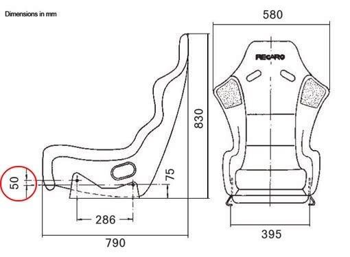

            quick Q, would these work for Bride seats? Do you do an E36 specific application or will these work?
            • Massive Lee
              • Sep 2006
              • 6782
              HI RAy
              Sorry for the late reply, I was "away for awhile.
              Check with Bride's specs to see if they follow FIA's mounting standard, which is 286mm between the side bolts. Here are the Recaro specs.
              To fit the sidemounts in an e36 with fixed mounting, all that is required is to fabricate custom bases with aluminum angles. What is the side-to-side and front-to-rear spacing on the e36 floorpan?
              One project I am currently tackling is the fitting of e30 sliders onto other floorpans thru adapters. The main problem, for a street car, is the compatibility of safety belts for a street car. For a racecar though, I have to check if the new steel floormounts are compatible with the e36 pan. Currently, they are compatible w/ the e28 and 39 floorpans.
