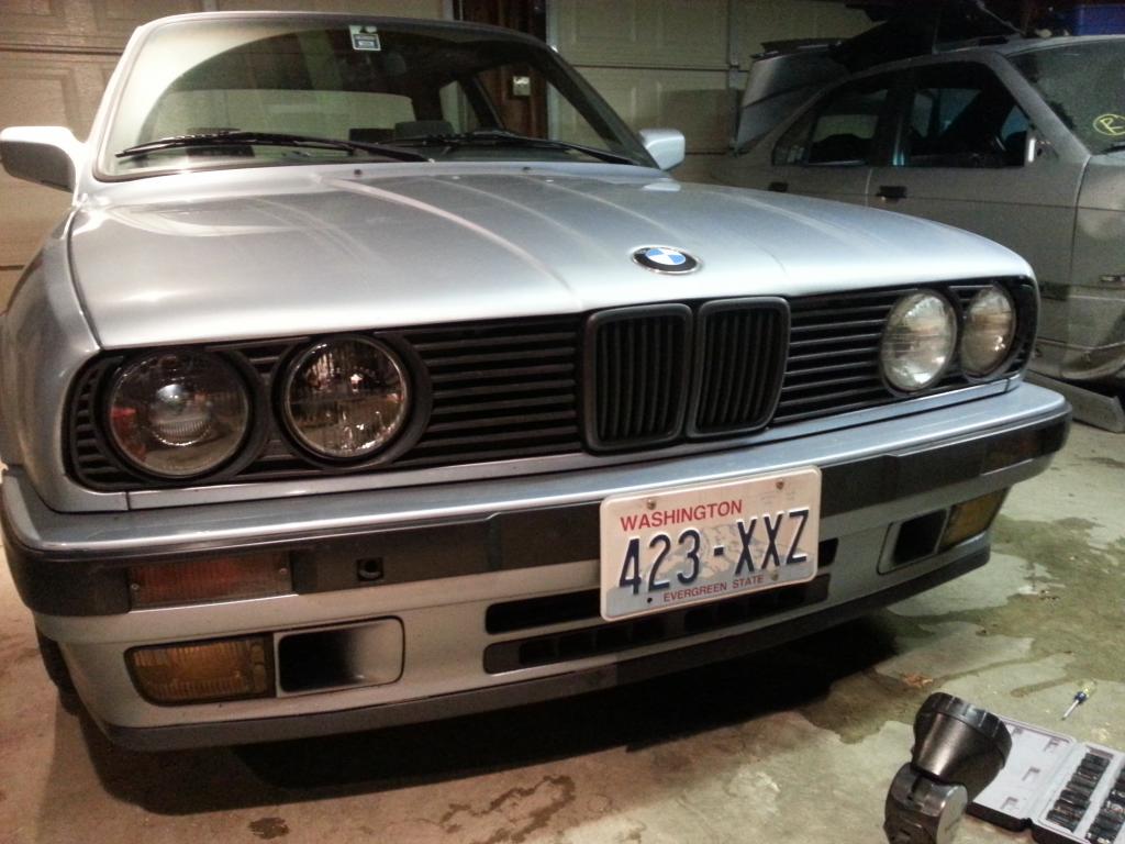

                        I got my lights on Monday. I was expecting the HID's that I'd ordered to arrive the same day. They didn't show up by yesterday, so I went to look for tracking info and realized that I had never completed my order. I wanted to install them, so I just went and bought some H1 bulbs and "194" amber bulbs for the city lights. Here's a pic with one side installed. I bought clear Lamin-x for the headlights and smoked for the "French" fogs. I'll post a picture when all done.
                        A heads up for everone installing these: The second adjuster for the low beams that doesn't come installed can be kind of a pain. Put the little four-tang'd piece in to the housing and then press the ball socket on the adjuster in to that. Do not put the piece on to the adjuster and then attempt to press that in to the housing... you will break the ear off of the housing (ask me how I know). I've repaired it and it works fine, but just be careful with that.
                        I'm happy with the quality of the lights. $200 shipped is much better than paying that much or more for old, pitted non-smoked lights with rusty adjusters.
