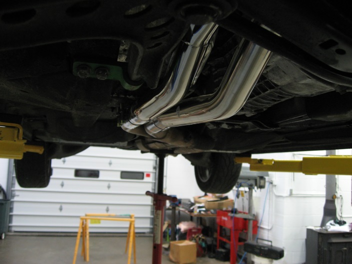

                                I bought these headers off of ebay for my e30 s50 swap and they fit fine.
                                While they come with .397" spacers for the engine mounts, I only needed one .067" washer on the passenger side to clear the subframe.
                                Notice that one of the header collectors is smaller near the end? This is because the stock e36 M3 exhaust uses a smaller downpipe for the rear manifold.
                                As for fitting onto your exhaust pipes, if you are using the stock e36 M3 midpipes as I was at the time, they fit easily after you cut the pipes to length. I only had to lightly tap with a hammer one of the supplied couplings onto the pipes but otherwise, it was easy.
                                Mine did not leak at all - I know because I have a lift and checked them several times, but I have to admit I only had them installed for a week.
                                Only a week? I had the stock e36 midpipes slapped onto a stock e30 325i muffler and the muffler was strangling the exhaust killing performance. Since fixed.
                                Here is a picture of how the headers join the stock e36 M3 pipes.
                                In my opinion, these headers are a great buy for the money and are easy to install if you remove the passenger side engine support bracket and motor mount.
