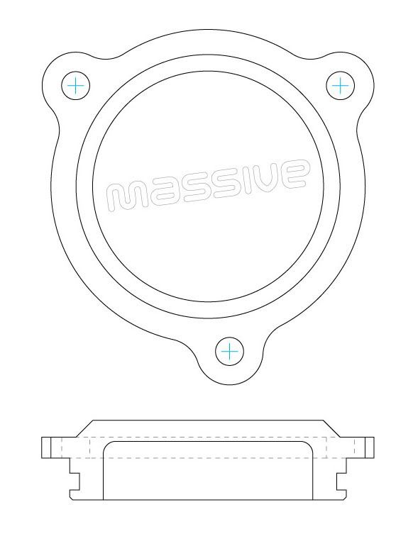

    Massive - S14 exhaust cam block-off plate - $65
    I am currently producing a batch of T6-6061 aluminum block-off plates, to be installed with an aftermarket engine management system using a crank mounted trigger wheel such as a Megasquirt or Electromotive. In 3 weeks, I will have 20 to 30 units made, offered with clear anodizing as well as black anodizing. The plates are mounted directly on the front of the cam tray and will seal from oil with the OEM rubber ring. It requires to remove the distributor housing as you'll most likely be using a twin-coil pack.
    The GB price is $65 plus $10 shipping for the next 3 weeks
    Post-GB price will be $85 plus $10 shipping
    5 units or more is $55 plus shipping (for shops)
    This block-off plate is not to be used with a cam sensor. If you want to use a cam sensor, then you need VAC's plate which bolts on top of the distributor housing.

    Lee,
    I have not checked S14 but there was some interest about doing this with the correct machining in place for a Cam sensor. This is one of the only peices I need before I go with a 4 coil set up or similar.

      Hi Tyler
      The cover for an cam sensor is a totally different beast. What you need is probably what VAC manufactures. it keeps the distributor housing. I could look into it later, but I must be fed some technical info. Location of sensor, clearances, gaps etc.
