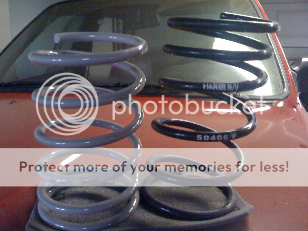

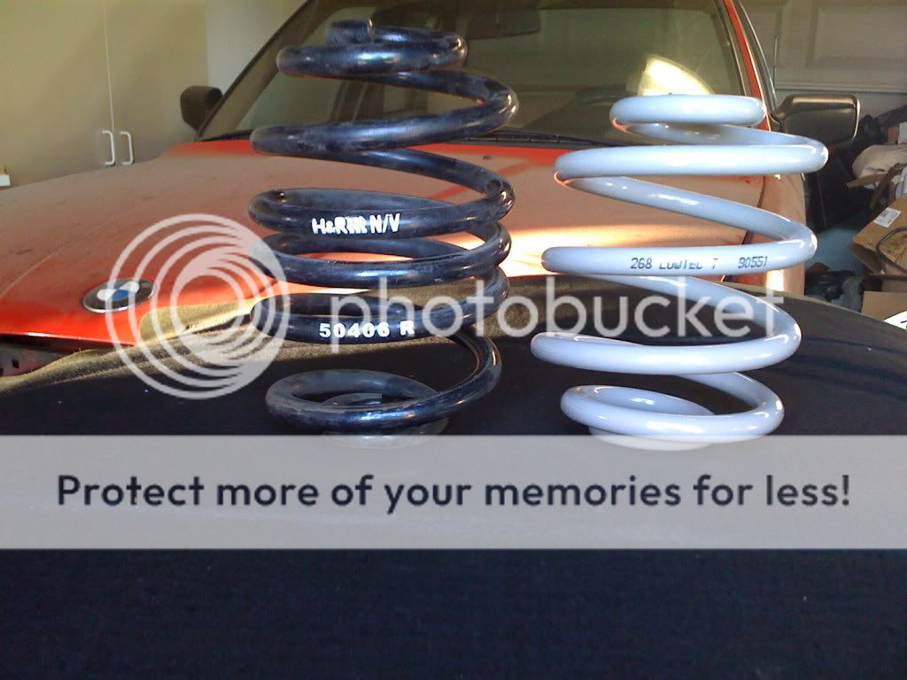

                Nope, i had some problems taking the damn control arms out so its on hold till this weekend. Here are the difference in sizes from HR sports and the 60/50's though.
                Dont mind my parts car back there.
                -Alex
                  shit. i think i got the wrong front springs.
                  i can't clearly see but what does your front springs say?
                  ps. give it some muscle. it'll come loose eventually.
                  best modification to any car is a clean car.
                  -jeff

                    • Uber E30
                      • 1409
                      #265
                      ya mine are 90503s you are fine
                      -Alex
