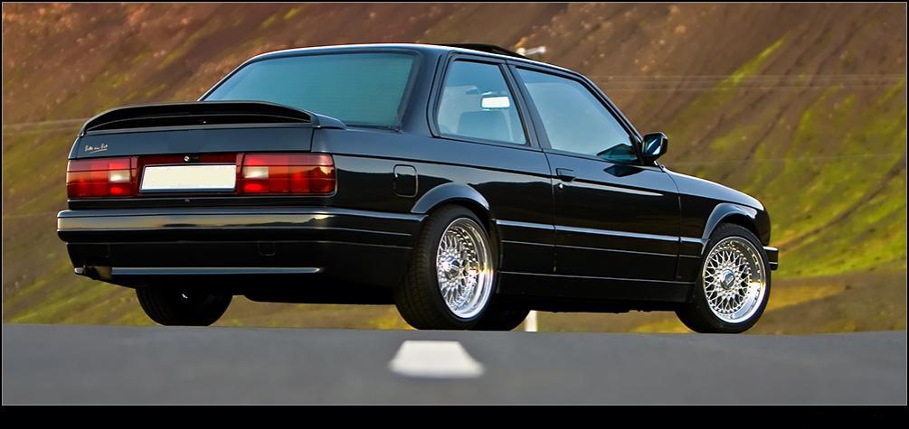

    This is a pix of real bbs rs rears are 16x9 et 0. Our wheels will look very similar:D our wheels will be 10mm more in. They used a 215/40/16 tire in the rear. It looks like the fenders have been rolled only. Im sure with our wheels (10mm more in) you can use a 215 or 225 on the rear with good fender rolling.
        Pic looks great from that angle. Do you have any others? I love the idea of a fat-lipped 16" rs replica, I am just not too crazy about "poking," which is why I won't be running the 9"s up front.

          uh oh, his thread says offset is 21 in the rear-which means the esm's will stick out 11mm further-which is not to my liking
          Originally posted by finnbogi
          I dont remember the offset think it is 0 in the front and 21 in the rear
          and I have 13mm spacers in the front , none in the rear
            Its ET 0
            Front : 8x16 et 15 strut 4/100 57mm (bmw E30)
            Rear : 9x16 et 0 strut 4/100 57mm (bmw E30)
            Dunlop SP 215/40-R16 rear / Conti 195/45-R16 Front
            That looks like et 0 in the rear...
