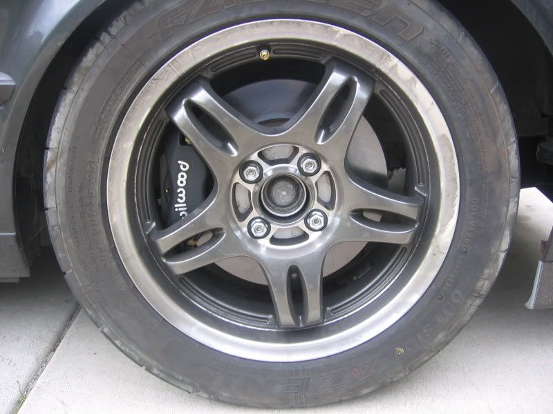

      No picture yet of the installed kit. Hopefully, 2002Maniac won't mind if I use one of his pictures. He used the Billet Dynapro calipers.

      Using 280mm radial clearance will be easier on many 15" wheels. Also, calipers are almost 1/2" narrower on each half.
      Don't hesitate to PM me for the pdf profile of that kit, to test against your wheel.
