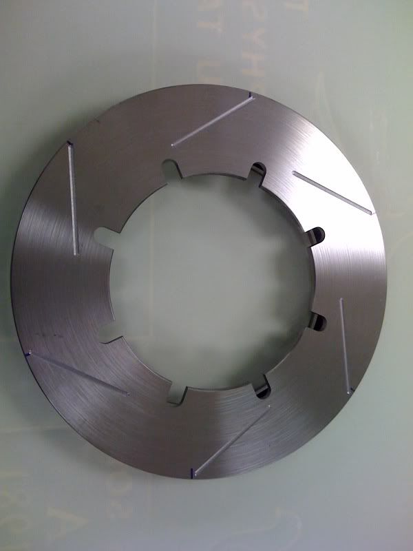

      Just got some pictures of the first floating discs for the float-in-the-disc kits. This is the 300mm x 32mm unit as found in the e30 M3 Rallye kit as well as the e30 front and rear Race kits. Older hats stay just the same and can be reused. Only rotors are different. They are slotted to allow the drive-pins to slide. Friction is between the pins and the rotor. Before jumping on them as an "upgrade" I'd like to highlight that they are for racing purpose as the floating system is slightly noisier than solidly attached discs. There's between 0.15 to 0.25mm lateral play, 1.5mm total expansion (will never go beyond .5mm) and 0.1mm pin play. Kling kling kling around town...

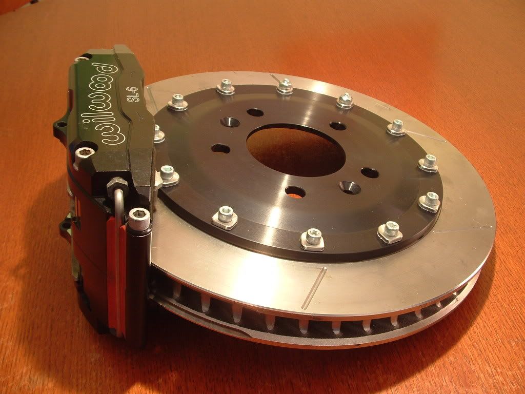

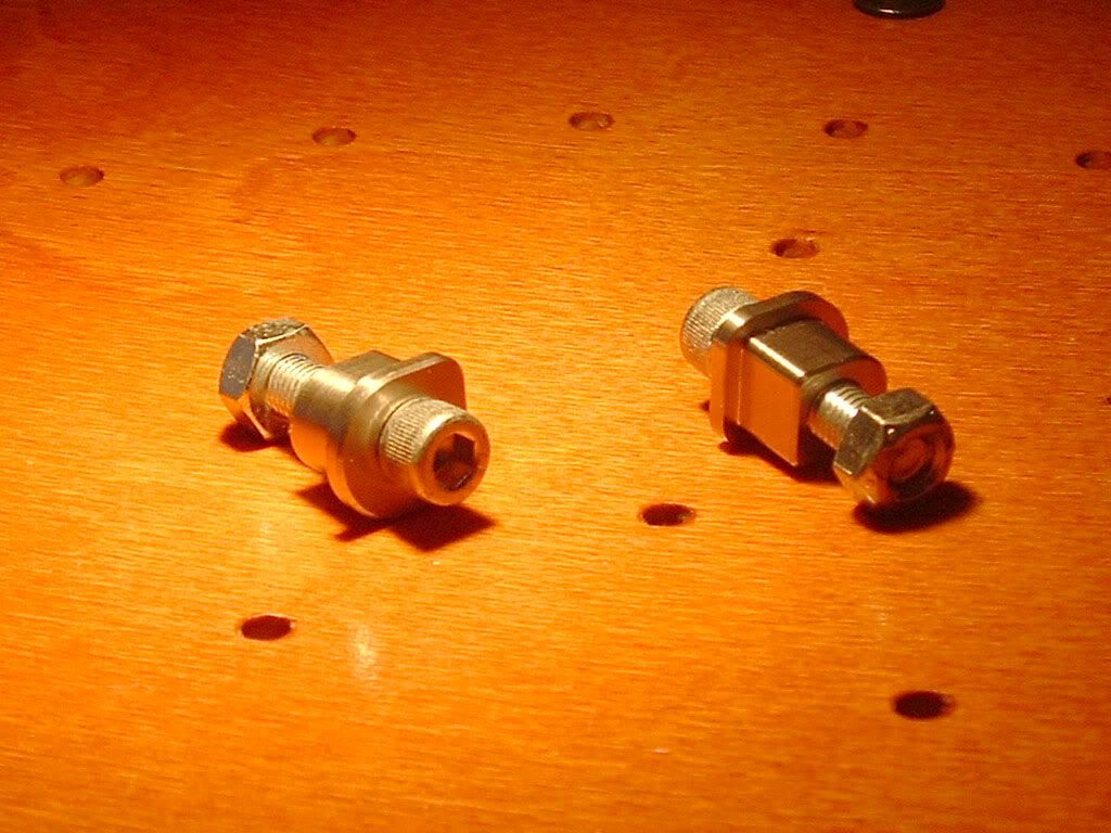

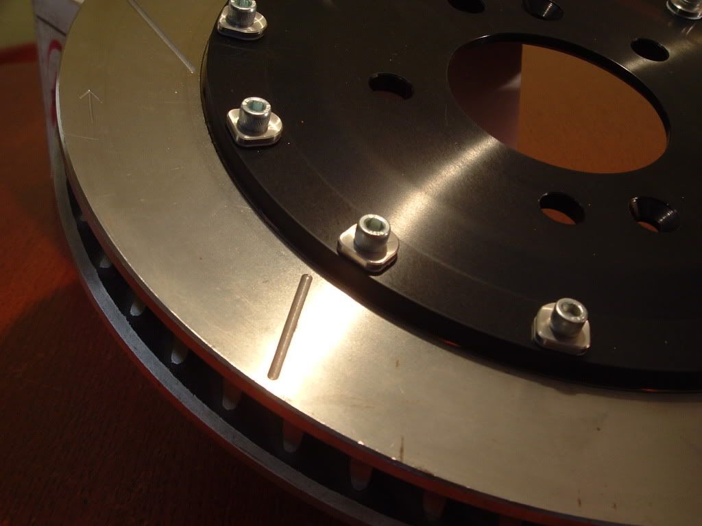

          I also developped a more expensive floating system where the float happens in the aluminum hats. They are slotted, while the disc is a regular one with regular mounting holes. Drive-pins are machined one-by-one from stainless 303 at a very high cost. Can you spell $200 per kit of 24 units as production cost?
          A teflon liner is inserted between the drive-pin's head and the hat to keep dust from blocking the slots, dampening noise, and improving the slide between the pin and the hat on each heat cycle.

            Floating rotors, radially mounted SL6R calipers with aluminum radial mounts. $1750usd. Deduct $175usd for standard solid mounted discs.
