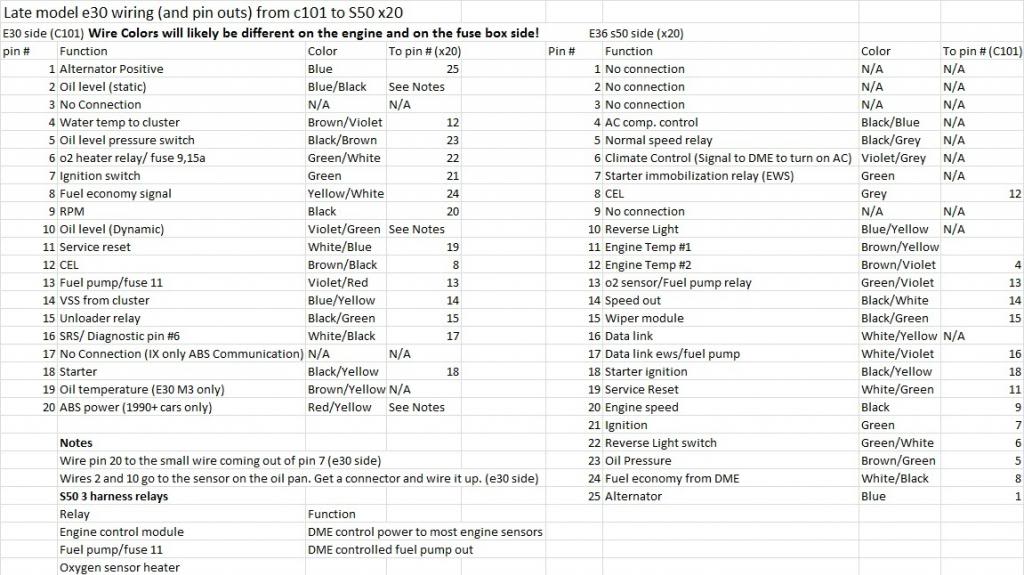

    So as i get closer and closer to completing my 24v swap the time has come for wiring. As i look there isint a good place to ask questions about wiring a 24v. I know it differs slightly from early to late chassis So hopfully this can be used as a place to clear things up and ask any questions needed.
    91 325is(chassis)
    93 325 (e36 m50)
    Now for the abs wiring Can i wire pin 20 ( abs power) to pin 7 (ignition switch) ? And can somone explain how to wire the oil level sensor connector? .
    I will be going off of this chart
