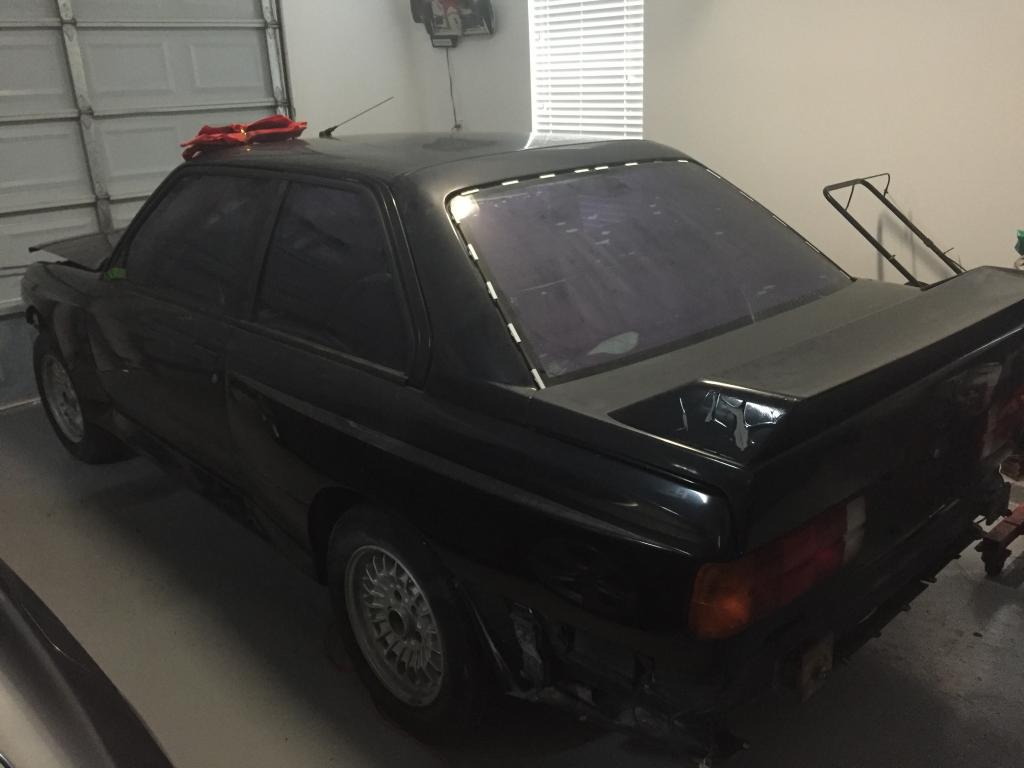

    im a new guy on here so hope i dont piss anyone off by asking questions. Ok so i have done alot of searching on this and it seems to me that the s52 and s54 conversion seem to entail the same body changes to fit the motor with a few extra for the s54 custom front subframe, oil pan , and trans brace. Both from what i have read require a DME flash from one of the guys on this fourm and i can also find all the wire harrness on here too. Wiring isnt really that big a deal to me as that is what i do for work as long as i can find the pins sockets and correct crimp tools and connectors maybe someone on here could tell me what connectors and pins and tools ect i might need. I do not like to cut drill or weld since i dont really have those skills (fabrication) o and i dont own a tig or a mig. I would like to learn though. So trying to keep my build all mechanical and electrical stick to what im good at. My question is for a car that will be driven two or three times a week and taken to the track maybe 3-4times a year which is the better choice and is the s54 in an e30 m3 really worth the etra money/work. The car right now is just a rolling chassis and needs lots of work see my pics in my album. And yes i would use the 6speed if i went with the s54. Really just wanted hear some other peoples thoughts on it. One more question havent seen it on here but has anyone done a diy for the gas peddel swap for the s54.
