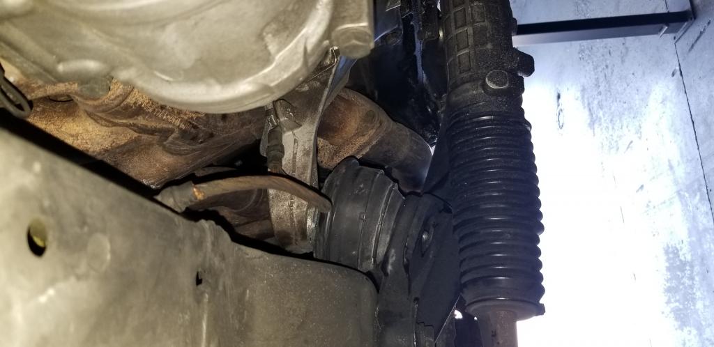

        I'm running e46 hydraulic motor mounts and I have much better clearance.
        The mounts are flipped upside down and the locking nipple was shaved down for fitment. Feels good to drive without vibration and knowing you won'ttake out your pan on the next speed bump.
