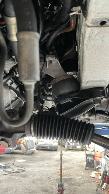

    I am tired of changing motor mounts and have been pondering a solution for the engine jumping out of place during intense driving.
    First I have to work out the y-pipe issue by rewelding it past the trans support.
    I have a feeling my exhaust may have something to do with it.
    I am thinking of using the e30s secondary trans bracket to somehow ground the transmission down and prevent the engine from jumping forward.
    or maybe use the stopper that is used on the trans pn# v With the brake kit installed I need the engine to stay put. any know solutions for this problem? Search brought me nothing.

      I went through the green ones quick pulled the entire metal screw part out of the polyurithane. I got those off a car I parted from what I remember. found the e30 stopper and there is nowhere to bolt it on or weld it to The only avenue are the condor mounts they are cheap and they are a later production so they likely sorted out the kinks. ill take some picks of where im at now.

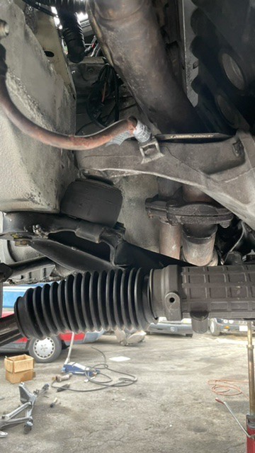

          At first I was thought of the rear suspension of my Buell when you mentioned the pitch damper.
          This last time the mounts likely busted from testing out the bbk.
          last time oil had penetrated rubber and track driving did the deed.
          engine only moves forward and not backwards.

                    drove my car with the elevated stock motor mounts, it felt a little Slower possibly cause of the half shaft at an angle?
                    there’s hardly enough space between the trans but I’ll try it while I’m under there.
