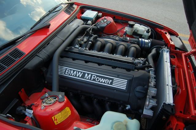

              sorry. Dont own any swapped cars right now..... except for this.....
              no firewall to mount the 318/m3 harness cover

                ^ wow. That is my dream swap. S54 set back in the chassis.
                • Farbin Kaiber
                  Lil' Puppet
                  • 29502
                  Originally posted by FredK
                  ^ wow. That is my dream swap. S54 set back in the m3 chassis.
                  Fixed.

                    yea, its a bit of a project. always wanted to get the s54 w/ 50/50 weight..... time will tell.
                    back on topic....just threw some engine bay pics in photobucket.
                    the black car had diag / main relays mounted on exhaust side. zip ties shown to keep wires tight in mounting bracket.
                    henna car had cover w/ broken tabs, couldnt keep the wires covered without zip ties on the outside.
                    cheerss, jason
