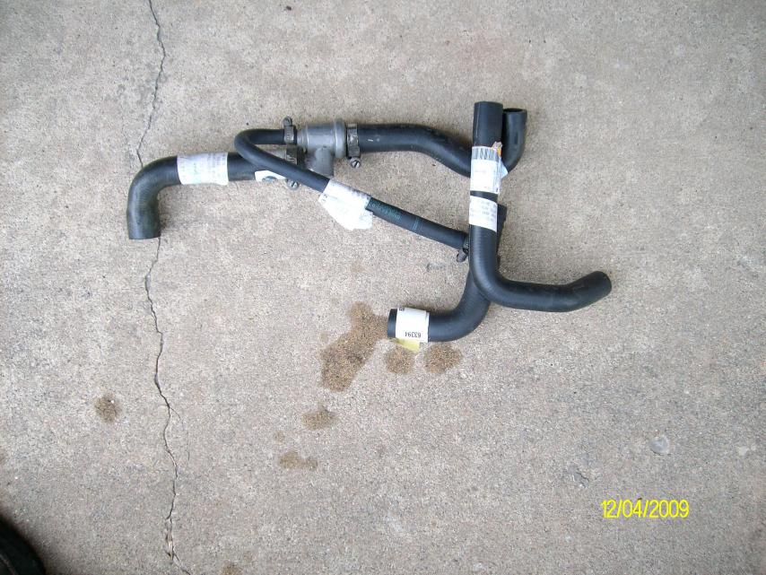

                I had a similar problem, temp low and no heat from heater. First I changed the thermostat (bought 88, but the bad one was 80), which solved the engine temp (now rests at the halfway mark), but not the heating issue. That in my case is caused by swapped hoses to the inside heater core. To save you time, hose from the back of the head goes to the bottom plug and the spider hose that runs from the front along the head goes to the top plug. In other words, opposite of how original e30's are plugged.

                            • Gnarles
                              • Dec 2008
                              • 342
                              my 89 325i has the same setup. I used the e30 setup when I did my swap.
