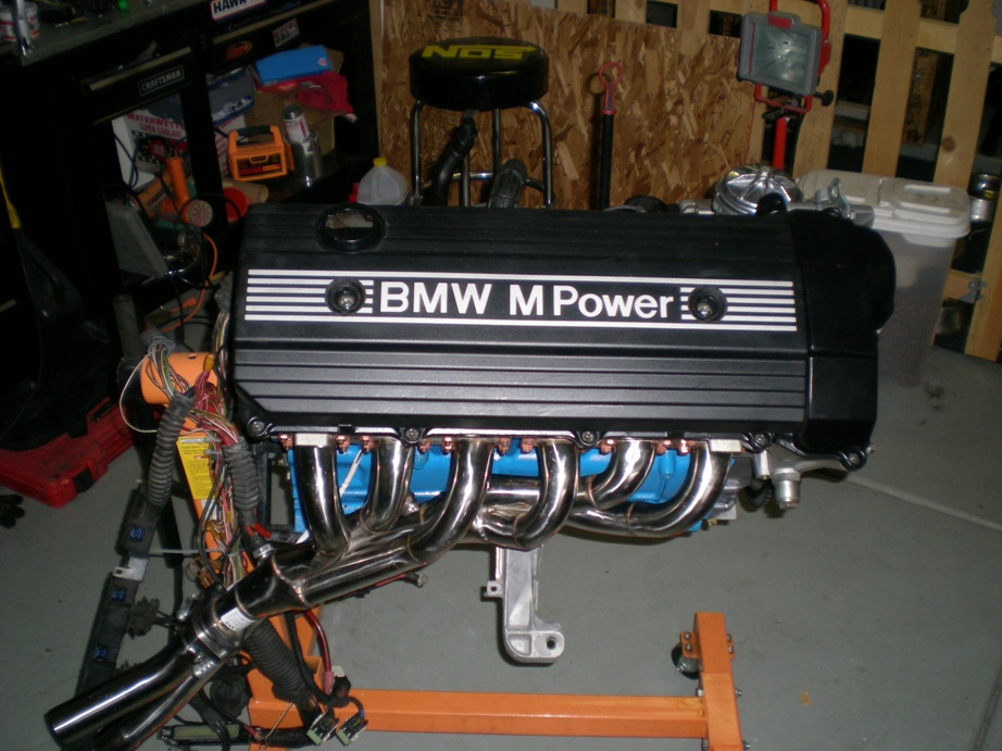

    I just pulled my M20 and I want to clean the engine bay for the S50 but I can not roll up the windows or close the sunroof . Any tips on what I need to connect to make that happen. Also if it helps the Radio and Blower are not working.
