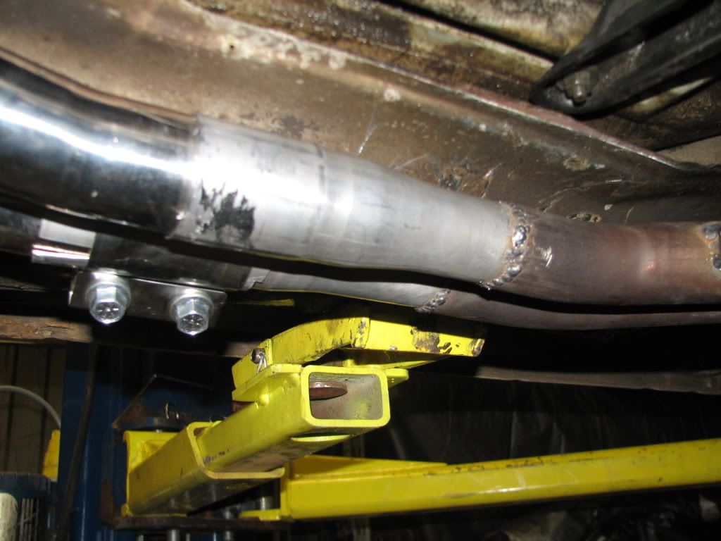

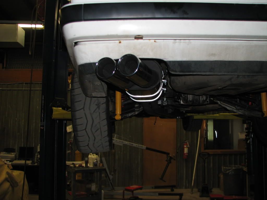

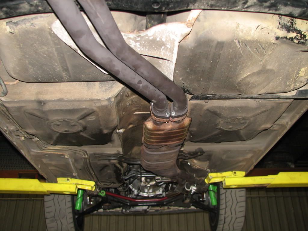

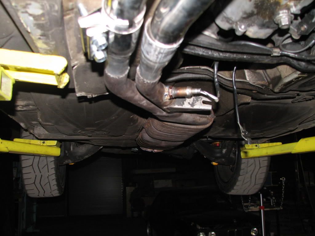

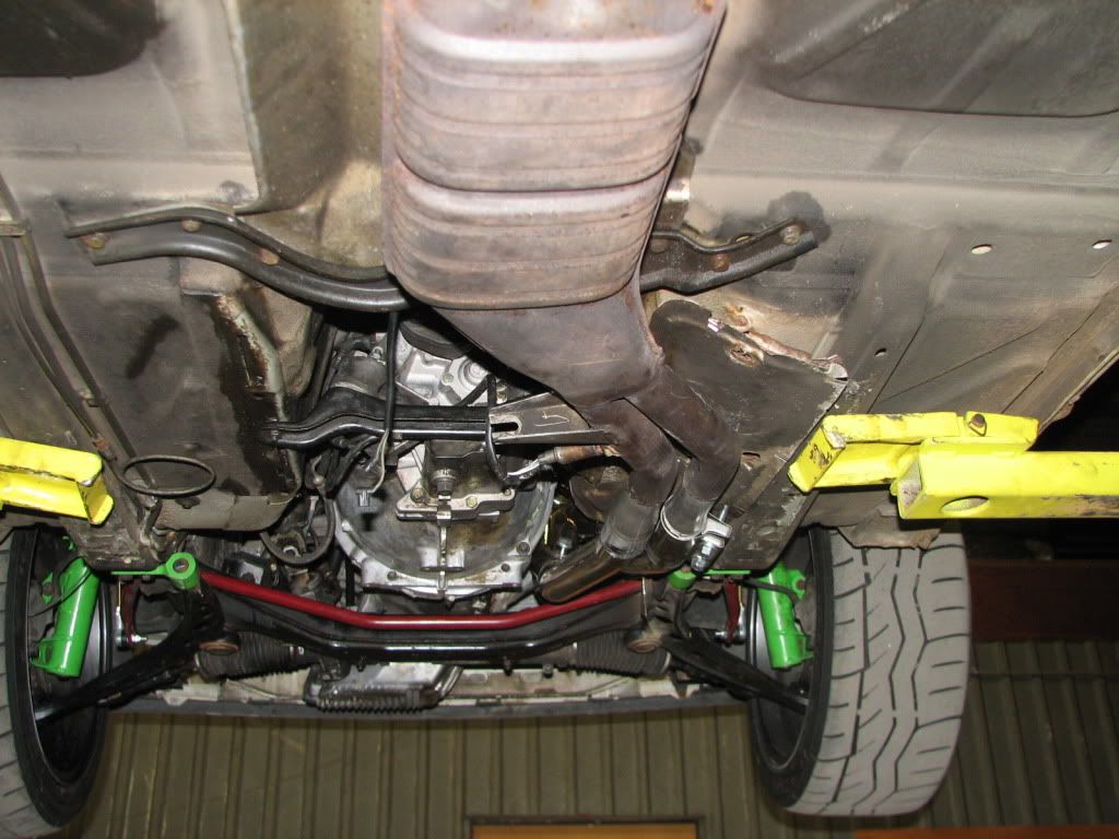

            Ok, here are the pics I took tonight with it still on the lift. Not the best, but whatever. Please excuse the dirty rear valence.
            E30 Remus Catback Section
            Catback to midsection:
            Midsection:
            Swaged pipes that were welded onto the midsection, then slipped over the headers:
            Another angle of the midsection:

                      Originally posted by th3blue
                      show some pics of how it clears the front subframe and sway bar please...
                      It's just the eBay headers w/ the passenger side shimmed up around .250" to clear everything.
