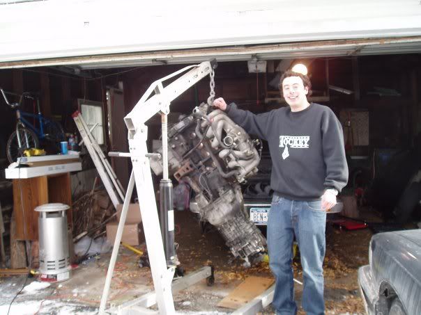

        first time i put my m50 in i used a load leveler and it was such a pain in the ass, even with two people. Second time i had no help so i used the metal loop bolted to the front of the head, took me 45min with tranny to lower it in and bolted up in place

          i've always used a load leveler, hooked to that metal loop up front by the timing cover (that always bends) and the spot just above the starter. Never had any problems.
          edit: here I am at 18 doing it with no leveler

            are you talking to me? i'm hooking it to that loop that you're talking about, mine is still straight, so much easier than a load leveler. I must admit you do have to raise the hoist a bit higher than with a load leveler.
            edit: just like that pic^^ but on an m50, maybe the m50s are stronger?:)

                  In all honesty that is not the safest way you should be carrying a motor. Applying the weight of the motor using just one brace that is held by two small screws is no where reliable. Yes people might be doing it all the time but it just doesn't add up. Please be safe than sorry.
