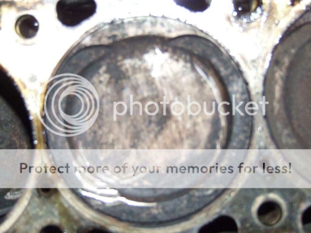

                • Uber E30
                  • 1409
                  This is the worst of it, the other ones just have a small grove
                  -Alex
                  • SiGmA_X
                    • Mar 2006
                    • 287
                    Clean the carbon off, finely sand it, and see how it looks. Don't go too deep, but do make sure its smooth.
                    :wgaf:
                    PNW BMW Crew ///
                    '93 325iS
                    '99 528iT
                    • matt
                      • 3732
                      That piston looks done to me.
