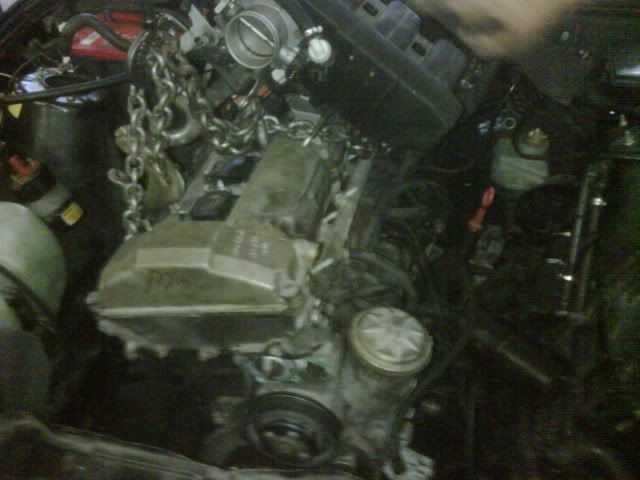

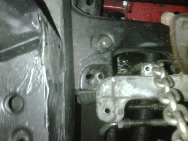

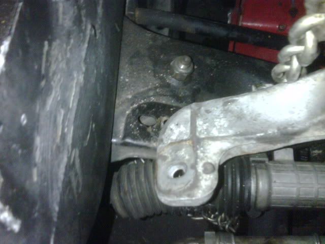

    I have a euro 90 325i and have a euro m50 that I can't get to line up at all. We have a screw driver inthe DS motor mount holes to hole it and called it a night. The pass side motor mount is about 3 inches too far forward and the head is on the firewall. The motor still needs to be tilted forward but we couldn't push it back that way. I am so stuck have very limited time tomorrow and then I am gone for a month. I just want to have this thing mounted. The car is on a lift with cherry picker and 2 floor jacks.
    This is what I have:
    e34 M50
    e36 motor mount arms euro
    Getrag 260
    87-88 535i mounts ( these are not green)
    Pass side mount, the angle on these doesn't look right

    I think your mount arms are upside down. But I cant really tell from the pictures. Take some pictures of the mount arms and motor mounts.

      I just googled it, found a pic and you beat me to it. I had another mechanic with me too and we spent 2 hours putting this in. They are upside down. Now I feel like an idiot. Can I use the e34 manifolds and e36 down pipes? I read somewhere that the e36 cats fit so I might go that route.
