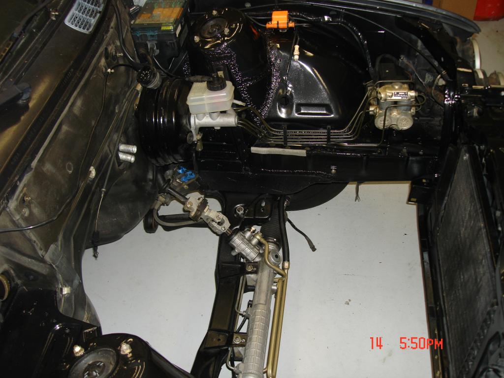

              here is where i am with the swap ....painted engine bay...CHECK!!

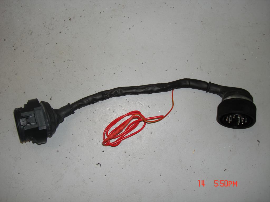

                ...and the plug i made up,checked leads 3 times to be sure

                  Do you have the stock spacer mounted to the back of that ix booster?
                    no spacers..

                      So just two bolts holding the booster? Looks great.

                          Thanks. I just found the fuel filter on my 318. And yes 2 bolts hold the booster. Easier than I thought. Also used e34 mc/res.

                            I'm running the same thing. I curious if that brake fluid res will fit.
