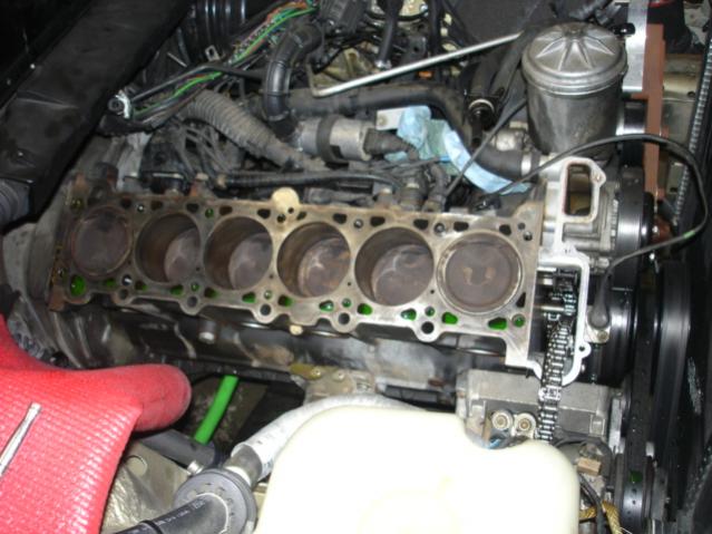

    Parts currently being installed at Racewerks:
    Custom TRM 60lb tune
    SS rep header, burns Y-pipe, 3" metallic cat, 3" exhaust tubing, 3" muffler
    .140 cometic head gasket/APR 2000 studs
    Rogue power pulleys

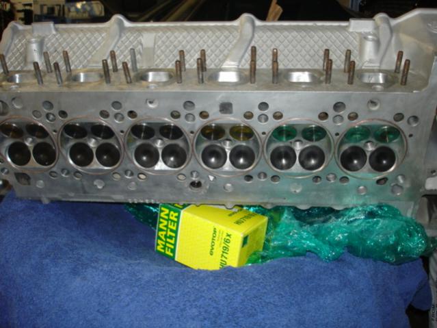

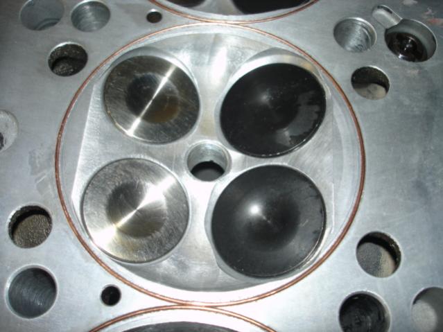

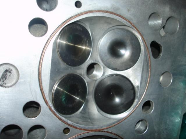

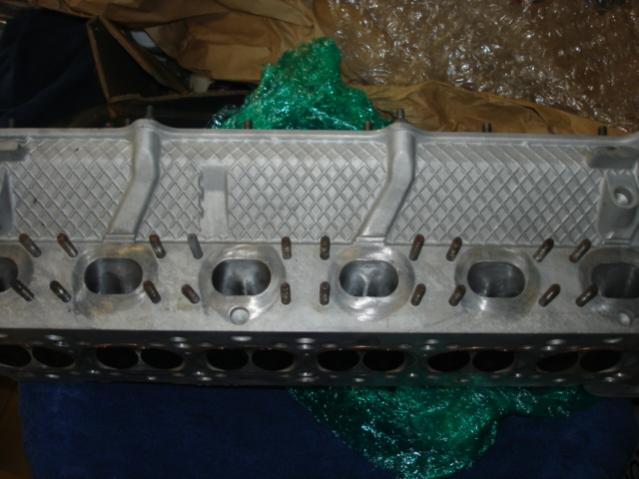

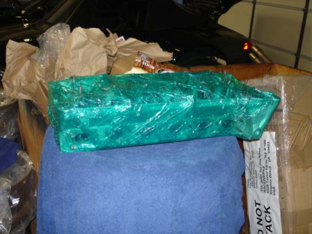

    Bavarian Solutions stage 3 CNC'ed cylinder head + oversized valves etc
    schrick cams
    T-trim with a 6.75" crank 2.95" blower pulley (18-20psi)
    60lb injectors
    AEM wideband
    2 new knock sensors
    BBTB

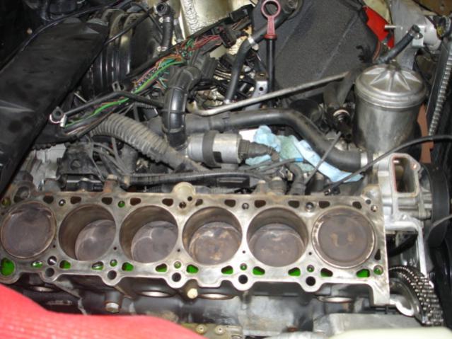

    I recently purchased an S52 that will be getting built when I return as well. I am building it for boost/daily driver. I plan on using Bavarian Solutions forged longer connecting rods and a custom forged piston. This set up should be strong enough to handle huge power while being up to the daily driving task.
    Here are some pics. I appreciate any advice or suggestions as well. I hope you enjoy this build and much as I do. I will try to keep this updated with pictures as much as possible but I am at the mercy of the installer.

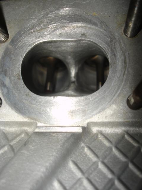

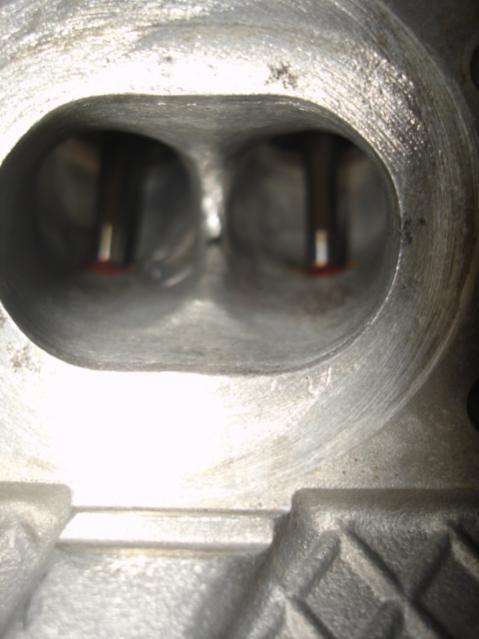

      Better pictures of the head over at BFC

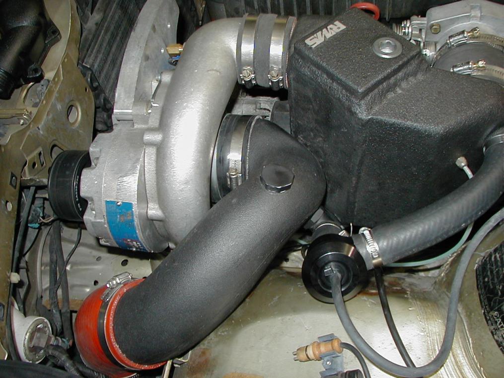

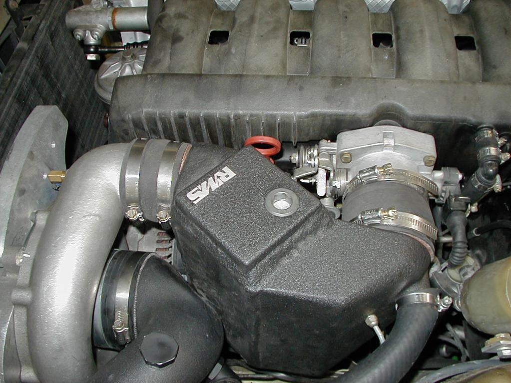

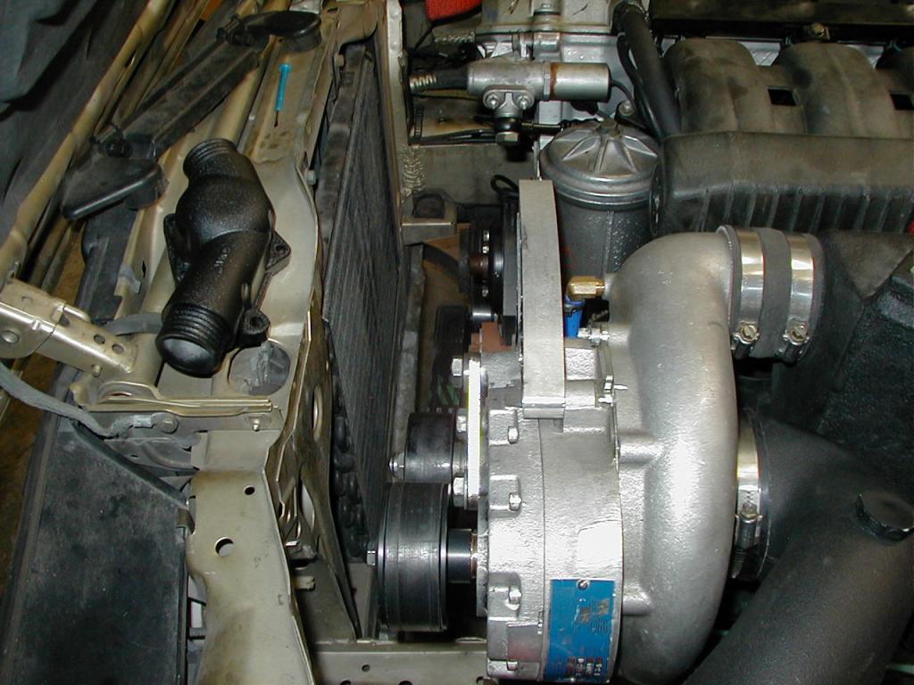

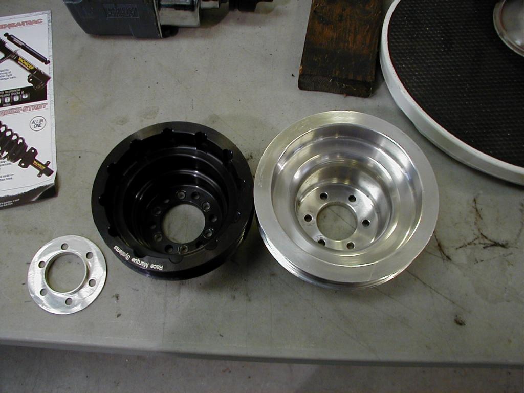

            Update,
            Here are a few pics of the T-trim install and the larger crank pulley. I have decided to go with a TRM custom tune for the 60's. Additionally, I found a guy on BFC that wanted to trade a 6" crank pulley for his 7". I am now planning to run the T-trim @ 58k rpms and hoping for 18-20psi.
            The car should be done this coming week. Once the engine work is done, the car will be going to my buddy's dyno shop to get the TRM tune sorted out. I hope to have some power numbers soon.....

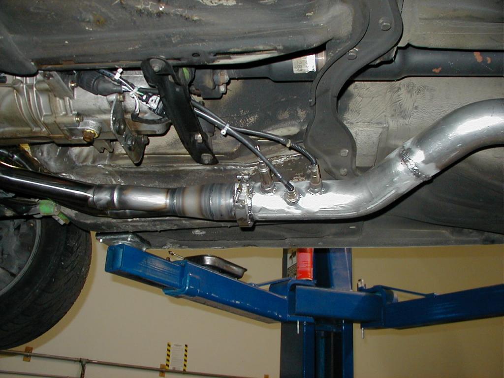

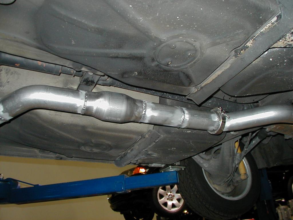

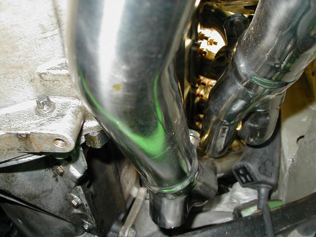

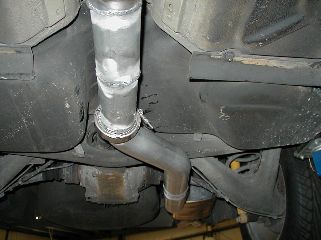

              Exhaust update
              The exhaust is almost finished. The shop is a race car prep shop and this is the first time they have done an exhaust. The welds aren't perfect but I am happy with the exhaust for now.
              They installed:
              -SS rep headers
              -Custom burns Y pipe
              -3" Magnaflow metallic cat
              -Magnaflow muffler
              -Magnaflow y pipe for the tail pipes
              -Factory O2, AEM wideband 02, LM1 O2
              -V-bands
              Post cat will most likely have a resonator installed so that portion is temporary.

                        The car is up and running. I am running Ebay SS reps, Magnaflow metallic cat and a maganflow muffler, all 3" and the car is way too loud. Last week I ordered a a dynomax race muffler to put post cat, hopefully this helps quite it down. Any suggestions?
                        Racewerks is also installing an IAT sensor and gauge. I hope to have it picked up and on the dyno this week sometime.
                        I will post dyno sheets when I have them.

                          Looks like quite a bottle neck at the "Y" for the headers...
                          • rneedham1979
                            • Jul 2008
                            • 852
                            Check out burns.com That is not a bottle neck, it actually increases the scavenging affect and is intended to make more power.
