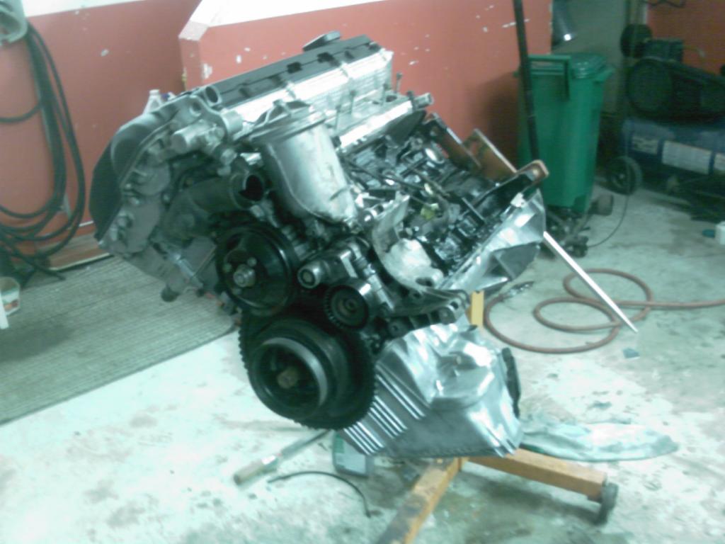

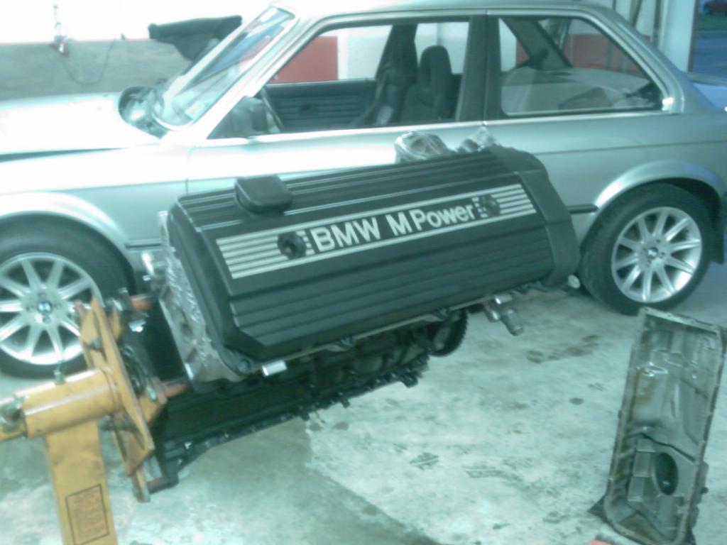

    Started prepping my s50 for my swap.Started with the oil pan and new valve cover gasket. I guess i should check the retainers since it has a 09/95 build date. Is this a big job?
