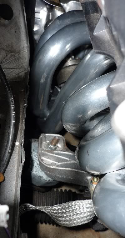

            One from the back of the alternator:
            And one on the exhaust side:
            Solid earths for the win.
