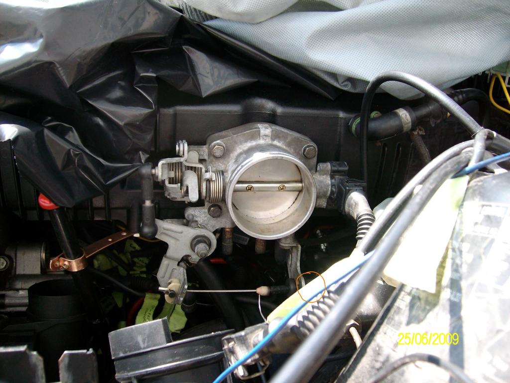

    3. Some are using the stock 318is throttle cable, some say the e34 m50 is too short. Anyone have a detailed photo of the throttle with the boot removed using the stock cable? I think I am missing a throttle cable bracket.

      3.) e34m50 cable works perfectly, that's what I'm using.

        3. e34 throttle cable works fine

          This is a pic of the E34 throttle cable on an s52 with OBD1 manifold/TB.
          With the throttle closed you can see that the cable is stretched taut...not so good.
          E36 cable is the same as the E34, when I compared them side by side.
          To get some slack at closed throttle with the E34 cable, shave some material off the trans facing side of that large anchor grommet....circled in orange. this will allow you to adjust more slack into the cable.
          m
            i used the 318i T cable works fine,.....same bracket, stock location too

                It appears that I am missing that bracket under the throttle body to the right in 7pilot's photo. All I have is a nipple that goes to my charcoal can.

                      I used the E34 throttle cable. Worked perfectly. Maybe they routed strange.

                              I used the 318 throttle cable and it works perfectly.
