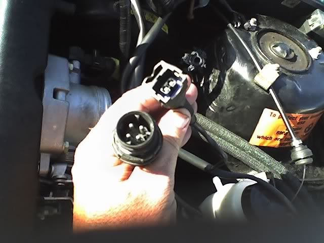

3) What are these 2 plugs? They are both coming from the drivers side of the main plastic cover on the s50 harness. (left one is not the afm)
