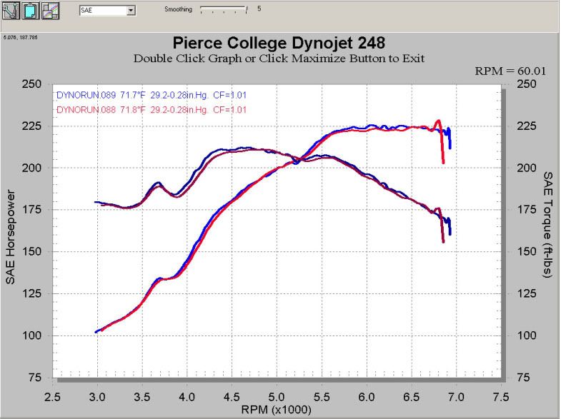

    Like the title says. I dyno'd my card today. It was a random dyno as I thought my cousin (who is taking a dyno tuning class at school) was suppose to dyno my car last week but it failed through. So he called me this morning and asked me to bring in my car. So I did. I didn't run a big fan infront of my car, when I should have because my temps got really high. I'm waiting on my teacher to email my dyno graphs and air fuel ratios. Because of some circumstances (one being my cousin doing the dyno run and not fully flooring my car, which might have been the reason why i ran lean the first run) I will be dynoing it again. But I'm pleased with the numbers.

    First run: Was running lean and hot for some reason when my cousin did a 3rd gear pull. Only made 215-225whp/210-15wtq (don't really remember).

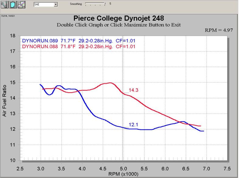

    Second run: I decided to do the dyno pull. 4th gear pull with a/f ratios around 12.9 - 12.3 but temp was still very hot. Only made 225-230whp/210-220wtq (don't really remember).
    Conclusion, pretty good numbers if my memory serves me correct (i need those graphs lol I might be wrong on the numbers). Could be better if conditions were slightly more ideal but I will redyno soon with a fan to keep my motor cool as it was nearing the RED area on my temp gauge as we were dyno'ing. My teacher who's been working as a dyno tuning teacher for over 20 years says I should be able to squeeze slightly more numbers with proper temps and running rich.
    He told me running hot and lean = power. And running cooler and rich = power. Running hot, and rich = less power. Running cooler and lean = less power. < --- Don't know if there's much truth to that.
    But yea, enough with my low numbers. Could it be my car? Could it be the dynojet? Who knows. That's what it is.

            Graphs aren't as good as I remembered haha. But yea, circumstances were there and I definately can gain more power with a better retune and custom midpipes (no cats or resonators).
            I definately should have made more power looking at the second run and a/f ratios but stupid temperature on my motor was so high i couldn't benefit from it.

                  Pretty interesting there's almost no change in power from being
                  like 15.1 to 12.5 afr.
                          Yup. That's what I find very interesting. The only reason is because my car was running hot. I should have seen more/better gains.
