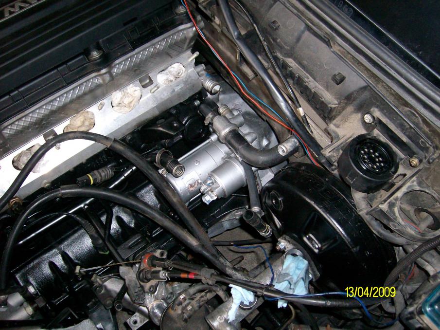

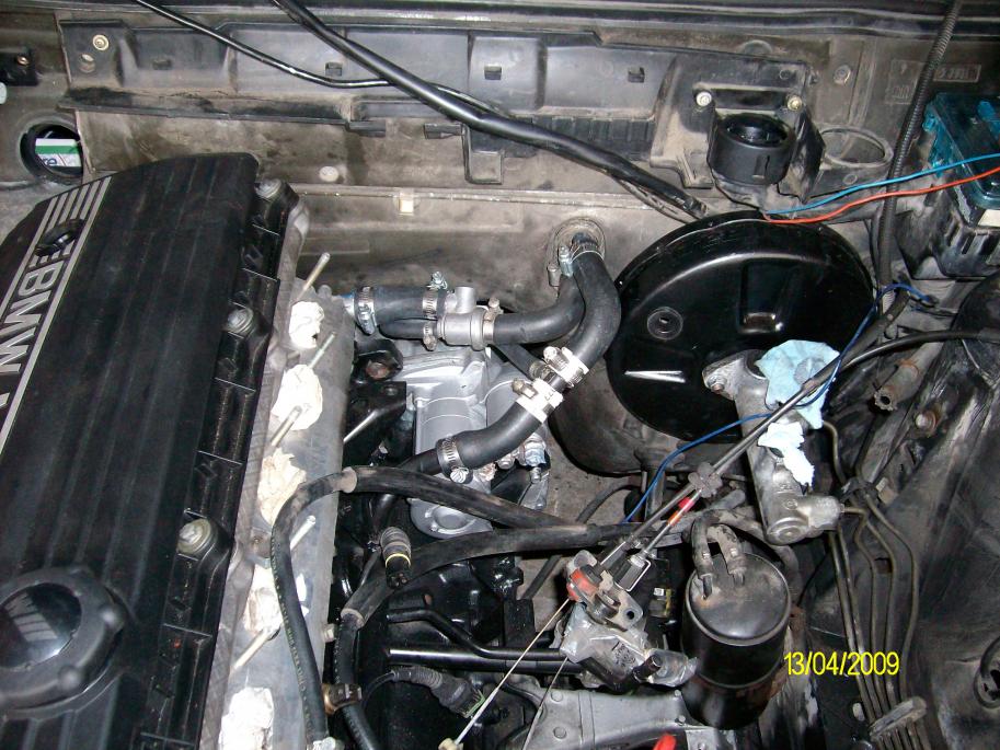

          Here is the mess I made.
          I used the Bypass kit so that I would not have hot coolant pissing on my legs.
          Bypass hose is from E30 M3.
          Goodyear 63393 for return hose with a Tee spliced in for bypass hose.

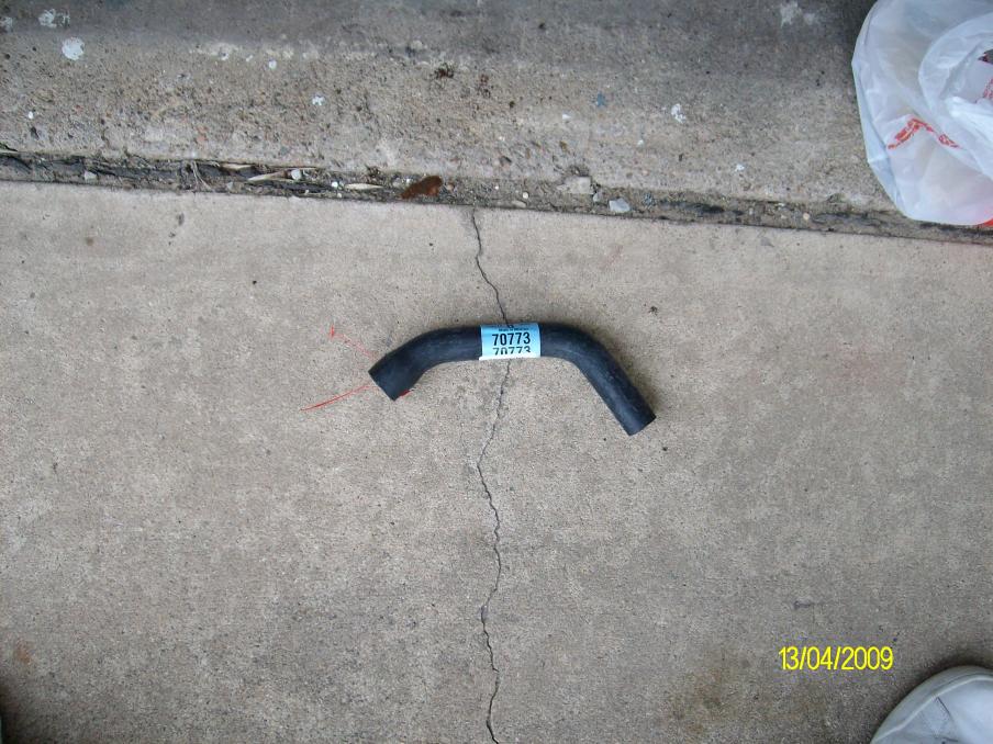

          Dayco B70773 cut for Bypass valve for heater feed pipe.
          Heater core tubes bent down.
