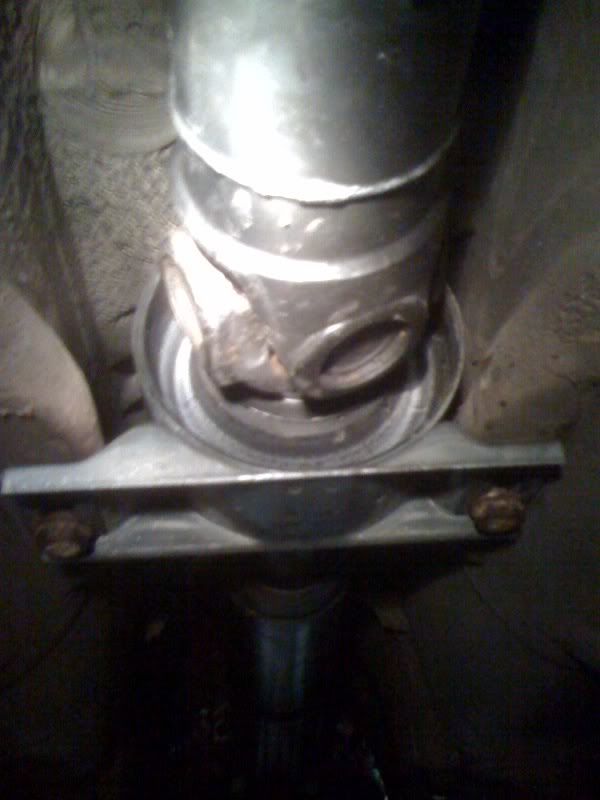

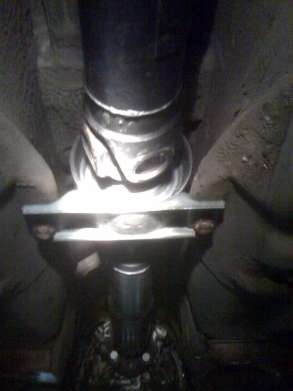

          Here are some pictures:

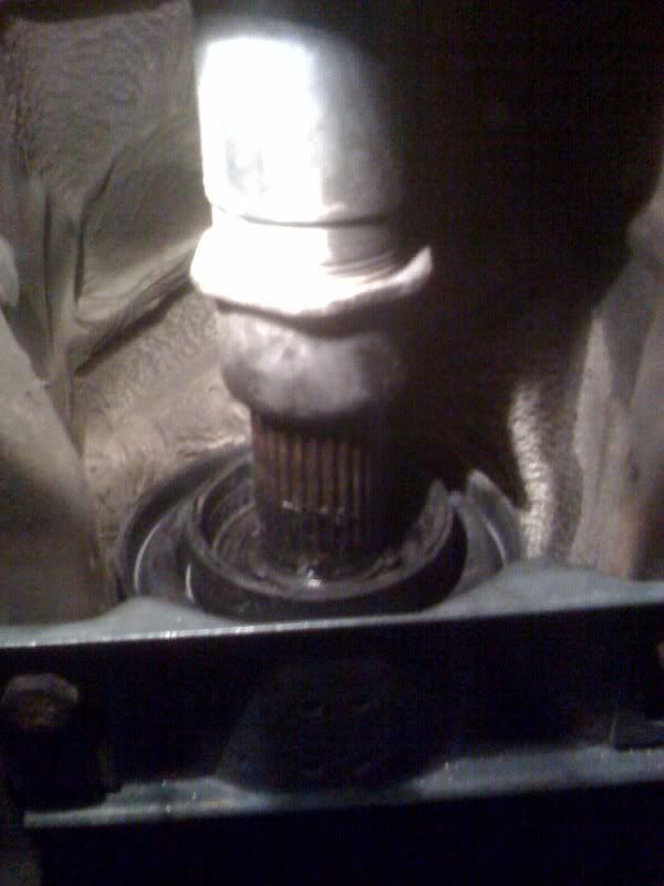

          With everything bolted up... here is the gap I'm talking about that is sketchy:
          Is that ok?
          Transaction Feedback!
            hrmm wow it shouldnt be that much, only suposta be an inch or so, that looks like 3.

              In the first picture, the "hump" on the CSB that is larger on the left is the driver side of the car- the shaft with the U joint being the rear half

                I just measured the gap, from the clip to the end of the big lock nut on the front half it measures 1.5'' is this normal?

                    Just got done with exact same set up. there is an inch of shiny spline showing About half way dude Just looked!

                          so final conclusion is that the e30 CSB needs to be mounted forwards (NOT BACKWARDS) on an e36 325 driveshaft??
                          people talking about both ways... i dont know which is right
                            Mount it the normal way you would put it on a e30 driveshaft.
                            SINdelle:E36 M3 5-Lug | 17x8 & 17x9 BBS RS | S52/ZF | 2.93LSD/3.5HFM/24lb Injectors/C&S Chip[B]SOLD[B]
                              agreed...I tryed and there is was no way I could get the circlip on,now mount to the normal way and it works fine
