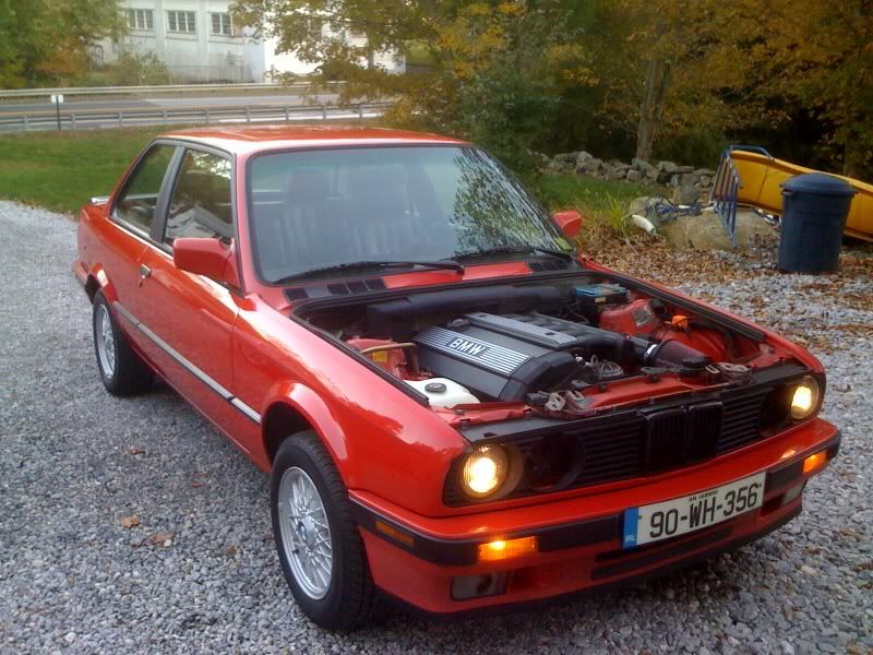

So I just finished my swap non vanos m50 into 318is. I drove it to the gas station today about a mile from my house and I had to baby the throttle. Giving partial throttle to accelerate would cause hesitation and unbearably loud back firing with open headers.
It has ebay SS replica headers, and no 02 sensor hooked up yet. I know the 02 will cause some problems, but will run in open loop and will be rich.
The backfiring was so loud it sounded like a pistol going off under the car so I had to granny shift my way home (not hard with 4.10 rear end).
SO... any ideas here? I unplugged the MAF to see if that was the problem, but it ran worse and stumbled and almost died when I did so.
My coolant looks milky but there is no sign of water in the oil (very clean after 1.5 hours of total run time). The car is at 666 fabricaiton getting the exhaust done right now so I hope to be able to drive it home this weekend.
Thanks in advance
