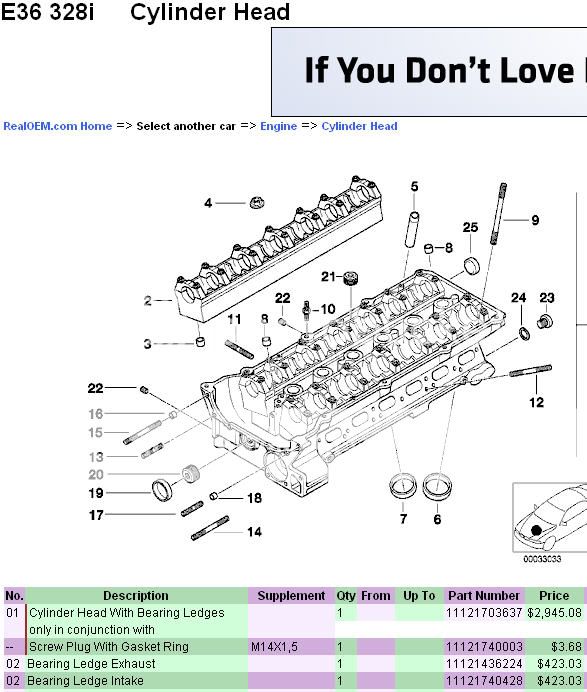

    Just for good measure:
    Notice the same PN for the trays and head??!?! OMG amazing!
    the S52, S50, M52, and M50TU all use the same head. The M50 NV uses the same head casting, but different valves.
    The M50TU, M52, S50, and S52 all use the same valves, but different springs and cams.
    -Alex

      Originally posted by Uber E30
      Not to mention the hundreds of posts that say you cant put m3 cams in a NV, you can only hotcam with another NV cam.
      Would you happen to know why? I do.
      Valves dont matter.
      Scince the trays are different do people swap them when they put s50 cams in a m50tu?
        Please oh wise one who knows more than real OEM, show me a running NV with s5x cams.
        -Alex

          Im running a 1996 M52 Cylinder head. Im running a "hot cam" NV set up (cams/trays/lifters) with no issues. Compression is spot on for the headgasket im using. I pull 21.5 inches mercury at idle. No extra valve train noise. Runs perfect. Probably about 1000 miles on the set up so far. Revving to 7100rpm every chance i get.
          And your vanos unit will not bolt up to a NV head, the casting is a little different and you have to grind a 1/4 inch off in one spot to get it to fit.
          And ill get you some dyno graphs this weekend or next weekend!! Do you need pictures of the head casting/pn and the cams inside it too?

                Yeah i had to grind down the right side a few mm to get the vanos unit to bolt onto the NV head. So what are my options for this NV head? Can i put vanos cams onto the NV trays and lifters? What about M52 cams/trays /lifter into the NV head? Right now i have M52 cams on m50 NV trays and lifters and its losing compression through the valves. TIA
                  gee i wonder why?!?!?
                  -Alex
                  • Manuts
                    • Nov 2009
                    • 11
                    So what cams trays and lifter are compatible with the NV valves to use in a M52 block? I already bolted the head to the block with a new head gasket so i dont want to take the head off to swap out valves. TIA
                      Actually this quite isnt true. s50, m52, and s52 all have the same trays. m50's are the only ones that have different trays.
                      Also m52 cams/trays can NOT go into a NV head, nor can m3 cams like suggested above. You also cant convert a NV head to work with vanos...
                      You can though put a S50 Exhaust cam into the NV intake side using the S50 trays, lifters and cams.
                        Cant i just put it m50 vanos cams onto the non vanos trays and lifter? Realoem lists the trays for the m50 vanos and m50 non vanos to be the same.
                          I dont think you can, i was pretty sure you just hotcamed with a NV exhaust cam. Anyone verify either way?
                            Should work
                            Its been done.
                            If you want to change to vanos you have to use all the timing gears from the vanos and lock the vanos if you dont want to convert all the way and tray I guess?
                                someone besides him
                                All exaust cams are the same. The only difference is this
                                Vanos Intake cam
                                Vanos intake and exaust
                                Non vanos cams
                                Non vanos intakes have the same flange in the front as the exaust and vanos doesnt.
                                Some one on here ran a s50 exaust cam in a non vanos Ill have to look for it.
