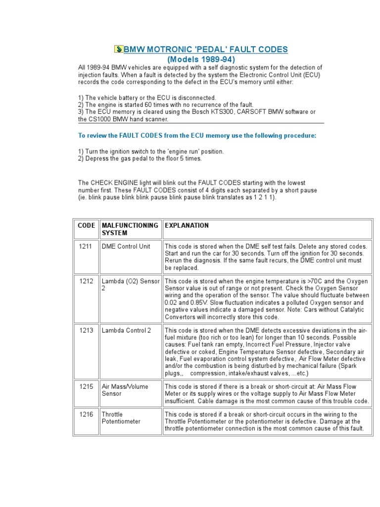

OBD1 Code Definitions - After Stomp Test
  • evil_twin
    • Nov 2007
    • 2965
    OBD1 Code Definitions - After Stomp Test
    Not sure if we already have this. I got this from Alldata, and I'm just posting here so after you do the stomp test you can see what the code means.
    Paypal: vdang5@gmail.com
    Delta Auto Care
    2875-C Towerview Road
    Herndon, VA
    703.435.1375
    My Feedback Thread: Evil_Twin
  • matt
    • 3731
    This list is a bit more complete:
    This document provides diagnostic codes and explanations for BMW vehicles from 1989-1994. It describes how to retrieve fault codes from the electronic control unit by turning the ignition and depressing the gas pedal. The codes are displayed as blinking lights corresponding to 4-digit numbers that identify issues like oxygen sensor problems, air mass sensor faults, throttle issues, and more. Explanations are given for each code along with recommended checks and repairs.
    • evil_twin
      • Nov 2007
      • 2965
      Nice Matt. Can we sticky something like this? It would be very useful.
      Paypal: vdang5@gmail.com
      Delta Auto Care
      2875-C Towerview Road
      Herndon, VA
      703.435.1375
      My Feedback Thread: Evil_Twin
